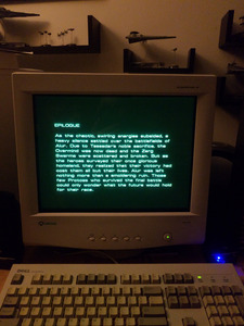

So I beat StarCraft on my Budget '99 Retro PC. Installed off the original CD I bought 22 years ago in April 1998.
Victory Screen
1.41 MiB
1483 views
I've beat a couple games on this build. Some I'd beaten before, some that were games I'd overlooked at the time. One thing that is constantly blowing my mind is that I totally forgot in 1998, when I was 14 years old, I almost always beat games with cheat codes. Especially strategy games. Playing them without now makes me realize how much I was missing.
Not sure what my next main focus will be. Been slowly playing through Unreal, and dabbling in Syndicate as well.

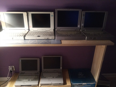

After fixing 3 laptops had to tidy up little bit to do some tests (benchmarks!) and post it later on 😉
Siemens 486 (PCD-4ND)
Toshiba 486 (t4850ct)
Toshiba P120 (700CT)
2nd Toshiba P120 (Tecra 510CDT)
Toshiba P133 (430CDT)
Toshiba P166 MMX (300CDT)
Well... I miss 80/90s ... End of story

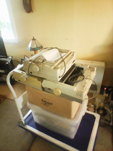

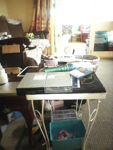

Dragged 3 dot matrix from out of the ceiling that have been stored there for over 25 years. A Super 5 24pin line feed printer, Panasonic KX-1191 and Pansonic kx-p-1180. I'll make a good printer out of the Panasonic ones as internally they share the same component using the KX-1191 body as that has not yellowed like the KX-P-1180. Shouldn't take long.

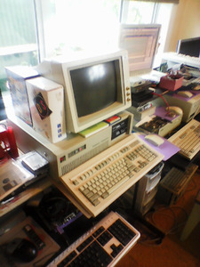

I replaced DR Dos 6.0 on my Redstone Computers XT Turbo system with IBM Dos 5.02. IBMs first version of Dos for consumer use on non IBM systems. It seems to run a faster than DR Dos 6.0 when executing programs. Also fitted the blacked HDD floppies in it. It looks rather smart.

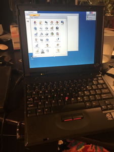

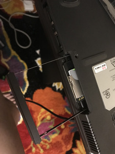

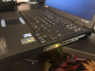

Spent the weekend trying to get BeOS installed on my single-spindle Thinkpad 240. The T21 is still down (somewhat) due to the blink-of-death issue, and it doesn’t really have a caddy that can be used for SD-to-IDE adapters. What to do? The Compaq Evo N600c to the rescue. It’s a Tualatin P3m laptop, one of the last machines with both AC97+Legacy SB Pro hardware support (albeit with software wagetable FM synth).
It also has a HDD mounting rail that works well with SD2IDE setups - this is something often overlooked when working with 2-spindle vintage laptops.
Rail in...
MicroSD is great for testing like this. It’s (relatively) cheap and easy to work with.
1.39 MiB
1333 views
Rail in
Rail out...
Although for heavy write situations this really need to be swapped out with an mSATA SSD and an adapter.
1.42 MiB
1333 views
Rail out
Was able to get the BeOS R5 Installer image working - too bad not much drivers are available.

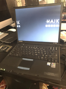

What about Haiku?
1.63 MiB
1333 views
Haiku fail
For some reason Haiku refused to boot up on the Evo n600c (freezing up on GPU init) but running the SD card as the virtual drive in VMWare player seemed to have worked. Not that it mattered that much, mind you. Haiku doesn’t work well on vintage hardware like this - on Beta1 r2 it’s missing drivers for Pre-AC97 audio, PS/2 trackpoint support is DOA, and apps like NetPositive requires SSE2 (which implies at least a P4/Pentium-M). It worked “okay” on the Tp240, but not enough for me to actually want to retain it.

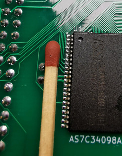

Built MCE2VGA, which required me to solder this SRAM IC, I think I never soldered anything this small so it was 'first time' for me, but I think it came out nicely...
Now I need to find somebody to program Altera FPGA for me as the cheap clone of USB Blaster causes bluescreens in my system (or maybe there's some solution to this problem?).

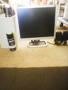

Purchased a can of beige matching touch up paint to refresh two 486 cases with surface rust. While I was in town I visited Cash Convertors. Got a set of speakers with AV connections and a HP 19" model L1910 lcd 4:3 monitor for the handsome sum of $nz14. The monitor is fine with no dead pixels.
