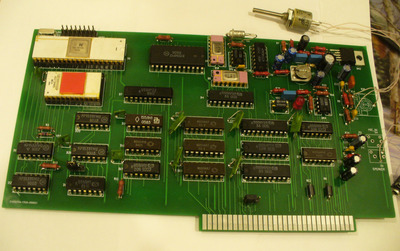

Reply 17588 of 27717, by Tronix
Soldered a clone of a SoundBlaster 1.xx sound card.

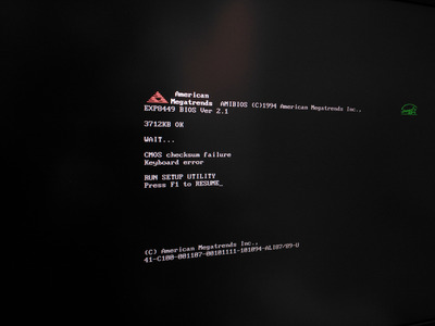

Reply 17596 of 27717, by Xicor
In one of my latest purchases I found a Expertchips EXP84491 V1.2 motherboard that included a 486DX2. The MB posted fine with the DX2 but failed with a more appropriated CPU ( for a pci chipset), namely an Intel DX4 or an AMD DX4-120.
1.36 MiB
978 views
No beeps, no bus activity,absolutely dead. Main voltages could not be at fault, so checked the core voltage and found that there was none.

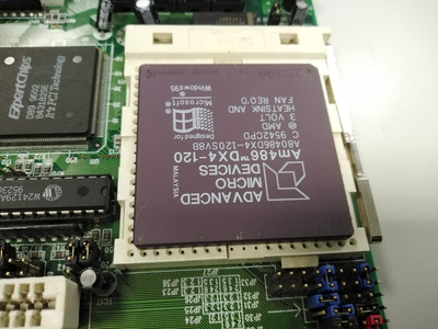

Turn my attention for the regulation circuit, and found that the trany D45H2A was faulty. After replacing tested the LP2951, and turned to be ok.
512.09 KiB
978 views
1.36 MiB
978 views
Do not be alarmed, this trany is what I had laying around, a new platoon of them are on route to a more permanent fix. The voltage core was now as expected.
Tested again with DX4-120, and now it boots.

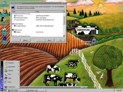

Reply 17599 of 27717, by fosterwj03
A few months back, I restored a Gateway 2000 low-profile 486 DX2-50 desktop PC. It came with an 83 MHz Pentium Overdrive processor, and I added a few upgrades as well. Below are the new specs:
Intel 486 LPX Motherboard with ISA Riser (5 slots); 33 MHz Bus Speed; Integrated CL GD-5428 VLB Video (1 MB RAM)
Pentium Overdrive – 83 MHz
32 MB FPM RAM
40 GB EIDE Hard Drive (Bootable Using On-track Disk Manager)
12x CD-ROM Drive
1.44 MB HD Floppy Drive
NE2000 Compatible Network Card
Opti 82c930 Sound Card with Integrated Wavetable and EIDE
I might sound crazy, but I decided to install NT 4.0 SP6 in a dual boot with DOS. And, it isn’t terrible. It boots in about as much time as a P4 takes. It runs MS Office apps without any problems, and I can play MP3s with Media Player 6.
I have to say that I actually like NT 4 better on this computer than Win95. Much more stable. If anything, the Cirrus Logic graphics hold it back quite a bit with 1024x768 resolution limited to 256 colors in the default drivers. Overall, I do think NT runs just fine on this platform.
