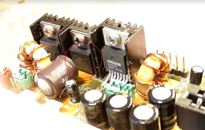

Today I repaired Soyo SY-5EAS motherboard. Voltage level on Vcore was very low, 0.7-1.1V after MOSFET.
Found broken shorted MOSFET by measuring voltage drop of gate resistor. Because MOSFET gate impedance is very high, there should be very low voltage drop. This one had several volts due to gate(1) pin was shoted to drain(2).
After MOSFET replaced this motherboard posts fine. Wonderful feeling...

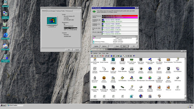

I spent some time over the last few days re-installing Windows 95 Retail on my Core i5 overkill PC. I jacked up the previous install trying to get a Matrox G550 PCIe to play nicely with Win95 (in short, it didn’t).
This time, I edited the Windows registry to remove all of the calls for Nvidia’s helper apps and taskbar icons to stop the .DLL error messages every time the system boots. Windows loads the drivers for my GeForce 6800 GS (PCIe) quietly now.
If I had one complaint about Windows 95 Retail, it’s that 8 GB of hard drive space (partitioned into four 2 GB drives) just isn’t enough for a fair number of Windows 9x apps, games, and media files. It didn’t seem like it at the time, but FAT16 has definitely gotten long in the tooth. I have Windows 95 OSR2 on a 64 GB SSD using FAT32, and I don’t feel any storage constraints with it at all.
I also didn’t realize that Windows 95 shipped without any support for OpenGL in 1995. Not a problem since Microsoft released an OpenGL update for Windows 95 and NT 4.0 later; just odd, though.
All that said, I’ve got Windows 95 back the way I like it and mostly stable.
