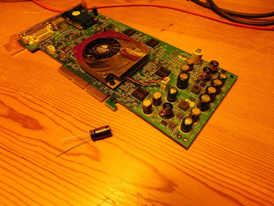

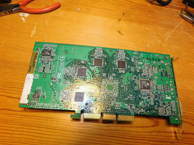

I did some other retro related stuff a few days ago, I replaced a few bad caps on a Geforce4 ti4600 and a single bad cap on a MSI motherboard from an Fujitsu computer.
The ti4600 with two visually bad caps, the third of the same type was also bad so I replaced that one aswell.
486.52 KiB
1831 views
Lead-free solder... I HATE that stuff... I had to add alot of real solder to get the nasty stuff out but everything turned out alright in the end.
602.23 KiB
1831 views

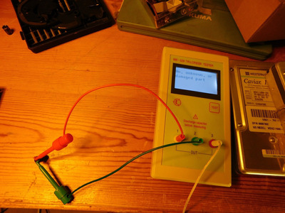

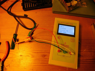

The old caps were baaad!
380.82 KiB
1831 views

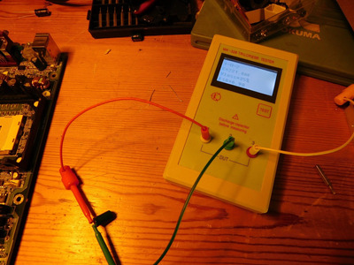

The new caps are better!

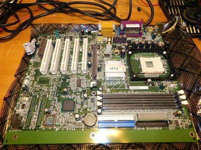

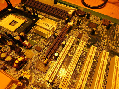

The MSI /Fujitsu board with one visually bad cap by the AGP slot.

The visually bad cap was really bad but I desoldered a few more of the same type and they all seemed fine, back on the board they went!

In this case I diddn't use an ultra low ESR cap as replacement but some cheap Panasonic FR series cap, I figured it would be "good enough".

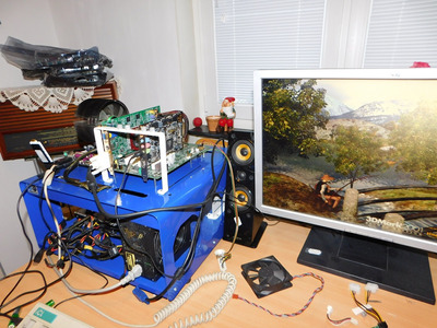

Did the Geforce4 ti4600 and the MSI/Fujitu motherboard work after the cap replacements? Yes of course they did!

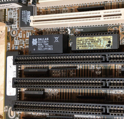

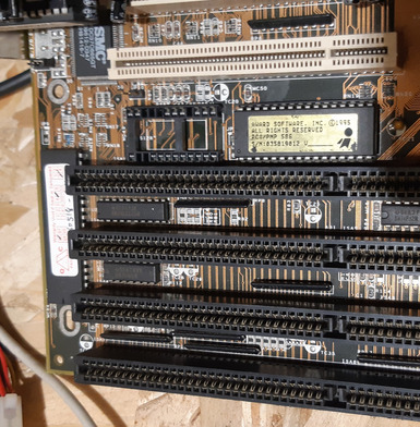

Replaced the ODIN/DALLAS RTC on my ABIT AB-PT5 I've got last month.
Desoldered the ODIN chip, soldered a socket to the board, recovered two DALLAS chips from two access control units. The whole process took me like 3 hours. I really need to practice my soldering/desoldering skills.
The "new" DALLAS chips are from 2011 and 2013 and bouth are working fine.
Here is the result:

The board works fine, another one saved from the scrap 😀

Focus on ESR. This is most important part as this indicates how capable the capacitor is to source sufficient current during short time transits spikes. Capacity of uF determines storage long enough to bridge largest voltage dips. But too much capacity of too few takes too long to react due to insufficient parallelism resistance hence, multiple capacitors in parallel.

Well the Panasonic FR series caps are low ESR, just not ultra low. The 1000uf 6.3v cap I used closly matched the 20 year old caps (of the same type as the one I replaced) still on the board when it comes to ESR so if it isn't good enough they all have to go.
It was good enough though and that's great as there is no chance I would waste 16 Nichicon HZ 1000uf 6.3V caps on that board. I guess poly modding could have been a last resort but I have only electrolytics at hand.
I was even tempted to use Panasonic FR series on the Geforce4 ti4600 but I read that it diddn't work for one person who tried while others said they used even worse caps ESR-wise when recapping GF4 without issues. At least the ti4600 has some real value but using expensive good quality ultra low ESR caps on stuff that has no (monetary) value at all dosn't make much sense and in such cases where scores of ultra low ESR caps are really needed I just keep the hardware in a box somewhere without fixing it.

Actually what I meant focus on ESR for health of the capacitors being checked, your tool has this feature. Do not worry about farads.
Polymer capacitors has very low ESR allows them to work even the farads is less than the normal electrolyte low ESR types.

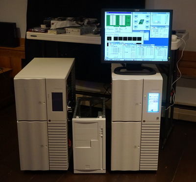

Spent the weekend getting the twins setup after almost two years in storage. In Win A500 ATX mid tower case in the middle for scale.

What on earth why no information on these twin computers? Are they intel-made servers?
Have some time taking these pictures and describe them in detail what are they? Web search is thin and your extra information will help big time.

Journey of a Unisys Aquanta HS/6, aka ALR Revolution 6x6

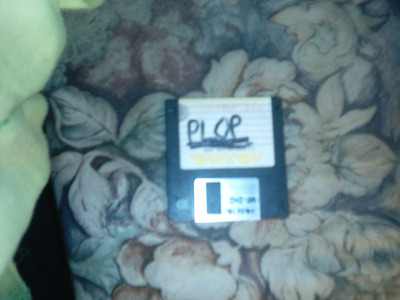

Use plop from a floppy disk to boot the cd... or a lighter linux cd such as Damn Small Linux or similar.
