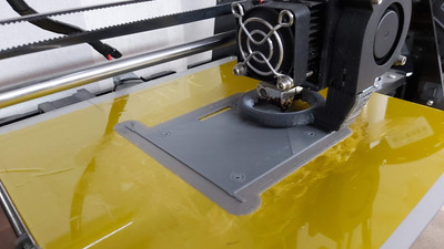

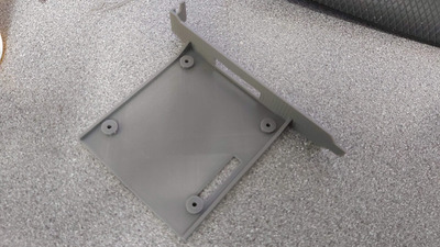

Currently 3D printing this https://www.thingiverse.com/thing:3543297 for my IDE to SD Card adapter

Cool! Someone did something similar here on VOGONS before, yours apparently is to be connected from the rear view, the one I saw before was for the front view, I can't recall who and where.

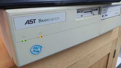

I can't put it on the front and spoil the looks of this! 😀

Haha, I agree! But the one I saw before, was made to look similar to a floppy drive and fit without modding the case. I tried to search the forum for the post, but I had no luck. I can't even remember who did it.

I remember a front bay IDE CF adapter recently. I was interested as that's the way I plan to go on a few retro systems.

Sounds good, but would need to find the right slightly yellow off-beige 3D printer filament 😀
Reply 17832 of 27716, by debs3759
🤣, of course 😀 I wouldn't be looking for a perfect match, as many cases are slightly different anyway. If I had a 3D printer, I'd probably go for bright colours anyway, coz that would suit my taste and clash less than the wrong beige 😀

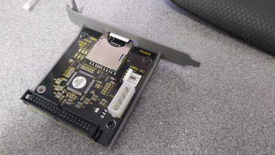

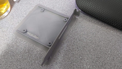

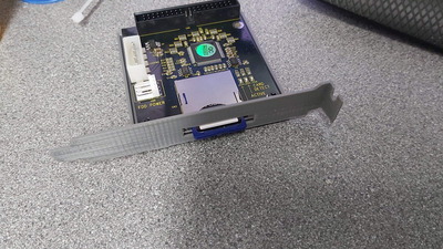

It's pretty good but could do with a bit of extra stiffening. I noticed on the original link there's a link to an updated one someone's done which is exactly that! (https://www.thingiverse.com/thing:4686963) I just didn't notice - but this is good enough for me, just bends a bit when changing the SD card.

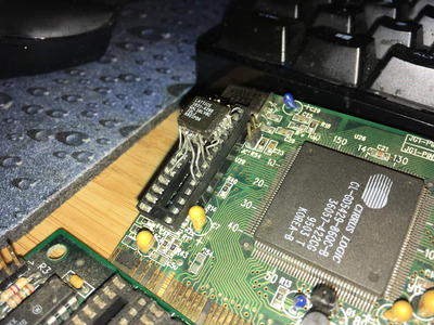

A few weeks back, I bought some non-working VLB graphics cards - one a CL-GD5429 and the other a CL-GD5426 / I/O Combo card. At this point I am not short on vesa local bus video cards, these are both novel enough to be worth fixing though.
Both are now working after fitting an EEPROM to each one (1mb eeprom jammed in place of 27c256/27c512), but the 5429 needed some more work - it originally came with a PAL chip to do 'linear addressing', which I still don't fully get what that does. It can have either that or a 74F32 in its place with some caps/resistors switched about.
Sadly I had neither and the UK's in lockdown again so I thought I'd make do with what's around - I never expected I'd find someone with my exact card re-engineered the PAL chip's code and put it up on Github: https://github.com/Tony814/GD5429PALMod
I found a GAL16v8 that could be removed from some useless printer ROM/RAM card (I knew it would be useful someday). Actually I tried 2, but one of them wouldn't write fully, I have bad luck with these PALs. Another one I bought off ebay had bad pins, so I've got 2 good and 2 bad ones 🙁
Flashed the GAL and made this unholy mess to fit it on the card, it works!

Amazing work getting that GAL attached to a completely different shaped socket! I would be terrified of that thing getting bumped and shorting out though. Are you planning to get a properly fitting chip? Or is it less scary in person? 😀

They probably make QFP to PDIP converter adapters, but I've only heard of them for the EEPROM programming tool, but how cool would that be if a QFP to PDIP converter adapter can be utilized in older computers?
