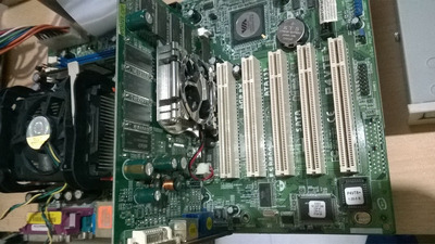

In the last few days I did some tests with an ASRock P4VT8 +, some time ago I changed the electrolytic capacitors, and the repair was successful.
Now I have put on a 2.8GHz / FSB800 P4 Prescott CPU, and have tested 2 PoV video cards one FX5500 and one 6800GT.

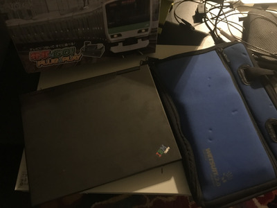

Might be getting a a Thinkpad 240X - thinking of messing with spdtool to reprogram a SODIMM module to report less memory than usual.
1.07 MiB
484 views
Densha de what?
Also, some stuff arrived in Japan for me. Looks like something to drive a train from 2003, and an old Japanese Thinkpad. Fun...
Also tested a USB-PD adapter for the old-school yellow-plug ThinkPads - ran at 20v instead of 16 so not something to use often, but works in a pinch.
