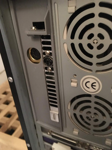

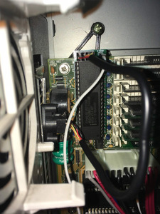

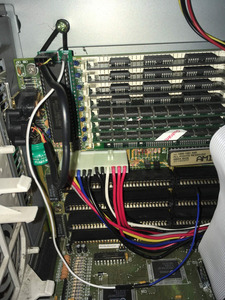

Yesterday, I got my 386 SX 25 motherboard to have working PS/2 mouse using this thread, with the PCB design and Rio444's utility: Native PS/2 mouse implementation for 386/486 boards using the keyboard controller
It works with this board, but it didn't work with the original keyboard controller, so I used this P8042AHP from another board that unfortunately stopped working.

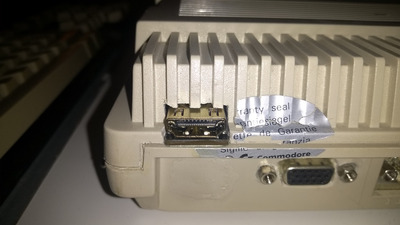

After having recieved and tested the Amiga500 RGB-to-HDMI Version2 adaptor for my Amiga500 ECS chipset. Then I needed to have a permanent installed HDMI-Port. So today I case modded my Amiga500-ECS machines case, to have that port permanently attached. It is not the most beautifull, and I need to file it a tiny bit more to have it straight.
For this casemod, I used a 50 centimeter flat-cable with male HDMI-Mini for the RaspberryPI-Zero, and a female standard size installed in the back of the case.
It will be so sweet to have it closed up and now it is future proved, in regards to monitor choices. 😜
