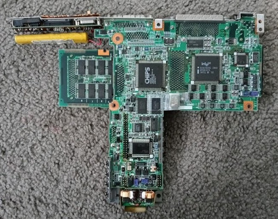

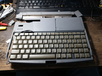

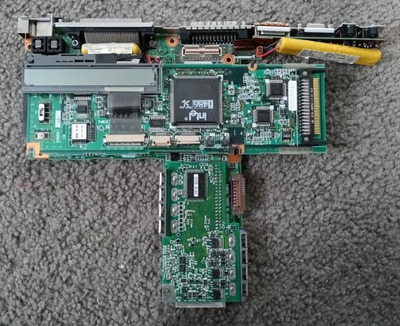

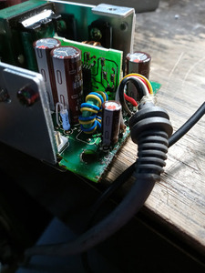

Started putting Humpty Dumpty back together - Humpty Dumpty is my 1993 NEC Ultralite Versa 25C that's currently....well....cracked up. Currently I'm poking around the motherboard figuring out why it's ticking when charging a battery, refusing to throw any sign of life onto the status LCD (found out how to get that to happen today), or why it's not powering on (other than a crystal oscillator that looks like a WWII era can of Spam left in the swamp for 100 years).
Here's the shortform rundown of all I found out about this thing since I started working on it
- plastic has shattered, leaving me a Jigsaw puzzle, but I might be able to BSSG (Baking Soda + SuperGlue) my way outta this one with some help from J.B. Weld and Guitar String ends
- Screen is totally shot but the controller boards will be good to reuse on my NL6448AC30-10 - I need to put some FFC connectors on the panel board sides and get some 30 pin FFCs for that
- Might be able to get around not having a screen casing by using the M/75 Touch Screen casing I have - and making it touch in lieu of a Trackball (the original Ultralite Versa had no pointing device)
- Original power supply (huge brick thing) is also shot, looks to be leaky caps, or whatever spill damage that did this thing in got the PSU too, Fuse is good
- Original Motherboard started to show signs of life with some poking around, but I'm going to need to desolder the power boards off and assess the damage underneath. Might need a few components replaced.
- There's a Toyocom 1.8MHz Can that rusted out on the bottom of the motherboard - no damage to the board itself, but that component....something liquid got to it
- Keyboard is badly yellowed, did this guy smoke a doobie an hour?
- 100MB HDD is still good - who in the heck put Windows 95 on a 25MHz 486 SL though is beyond me....it looks like Windows 3.0 may have been the original version (with DOS 5) given the Chess Wallpaper
- I've already removed the logos from the screen and retained them

    Sitting in it's "Hospice Ward" - If I can get the power supply and motherboard going, I'll consider fixing the case up.

    Bottom of Motherboard - notice the piece of Scotch Tape near the GPU - that's where I taped the broken off can to so I can look up the part and replace it. Seems like it's fairly availible and super cheap to replace.
    131.55 KiB
    491 views
    Top of Motherboard

    Leaky Caps in the PSU - might be why I'm getting no power from it, no other signs of issue.

    Humpty's case needs some serious help - got my work cut out for me

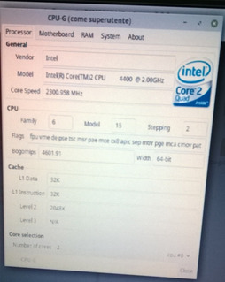

Finally today the 775 CPUs I had ordered arrived.
Of these five CPUs, only one was used for NewPC-Linux.
The CPUs are Pentium DUAL-CORE E2140 and E2160, CORE2 DUO 4300 and 4400 and 6320.
The 4400 went to the place of a P.D.C. E2180, on an ECS P4M890T-M2 motherboard with 2GB DDR2 RAM, the chipset is VIA.
Together with the CPUs, 3 SATA cables have arrived, I need them to connect various drives.

Finally today the 775 CPUs I had ordered arrived. Of these five CPUs, only one was used for NewPC-Linux. The CPUs are Pentium DU […]

andrea wrote on 2021-01-27, 20:58:
PC@LIVE wrote on 2021-01-27, 19:27:
If you can try running the 800FSB CPUs at 1066. All of yours will very likely overclock to 1066 very easily and at stock voltage for a considerable speed boost. In fact, I ran a E4500 (2200/800) at 2933/1066 with less voltage than stock (1.2something vs 1.325 specified I seem to recall)
Yes, I think it can be done without problems, the E21X0 can be overclocked until almost doubling the FSB, and without overvolt.
Currently the 4400 has been slightly overclocked by taking the FSB from 800 to 920, the frequency rises from 2.0GHz to 2.3GHz.
An E4600 that I ordered should arrive in a while.
Unfortunately the MB ECS has video built in, and I wouldn't want to cause problems by raising the FSB too much (up to 1066).
Try doing the BSEL mod with aluminium tape. That way the CPU will present itself to the board as if it were a genuine 1066 chip and all timings and dividers will be in spec.
