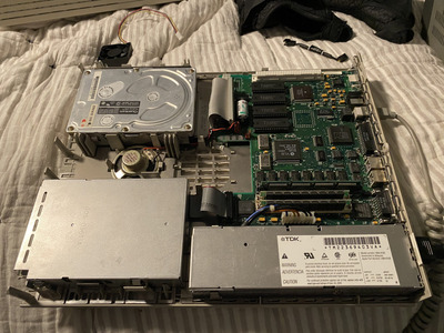

While I still don't have my DB-15 to VGA adapter in, I at least managed to get this baby up to the point of giving me a happy little chime.
1.57 MiB
2015 views
All it took was a complete recap of the logic board and power supply, and swapping out the slot RAM for some spares I have of currently unknown size. I will be booting it tomorrow in the sketchiest of ways, using a separate computer's PSU to give power to the HDD so I can see if there's anything on there/if it even works. After that, I sit and wait until I can get a SCSI2SD and maybe even a floppyemu if It's worth it, and figure out if there's a fan that will actually work.

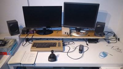

I have done some re-arrangement of my monitor setup. I have found the best solution and combination for getting a Commodore64 onto a modern display. My solution is a RetroTink 2X Mini and a Samsung MultiSync T22A300 television. For Amiga, I have my Dell 2001FP, that do accept 15khz signal, however is awesomme when using one of the RGBtoHDMI adaptors and a HDMI-DVI cable. And the Dell is a great monitor for vintage PC's as well. I have it running with a box, that prevents any monitor to go into sleep mode. Something that I have had issues with, when dealing with really old ISA VGA cards. Yup, even a few VLB and PCI cards as well. Anyway.... I can now use my setup for old 8bit computers, Amiga's and Dos computers. This entire setup, is the result of 6 years of fine tuning and testing tons of different adaptors, converters, upscalers and monitors. And I have my wonderfull Logitech speakers on the side of the monitors as well..... I will hang on to my other LCD monitors, and my trusty old Dennon CRT television. Just in case I need stuff for testing and repair.

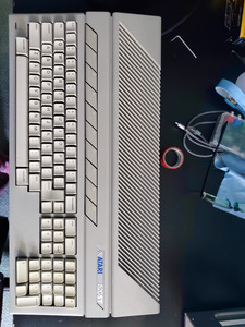

More goodies came in today!
First an Atari 520 ST. I gave it a good scrubbing inside and out because fucking yikes, the keyboard was disgusting when it arrived. Now it looks nearly mint, minus 2 missing plungers on the numpad.

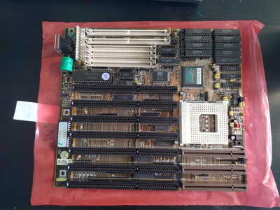

Next up, this nice Soyo VLB board. Soyo was suppose to be good quality I think? The seller claimed to have re soldered a new barrel battery into the socket. Looks fresh to me but probably should still be removed.

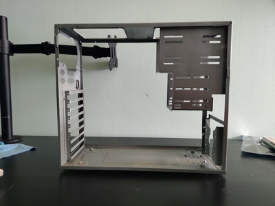

Finally, I took apart my only AT case to give the inners a fresh paint job and protect against more rust. Not the most even or tidy paintjob, but it's not gonna be seen once it's back inside the case anyway. It does its job.
1.26 MiB
1755 views
GPL-2.0-or-later
I gotta find some good beige paint and do the same to my PC98ce2 because, god, that one is disgusting with all the rust 🙁

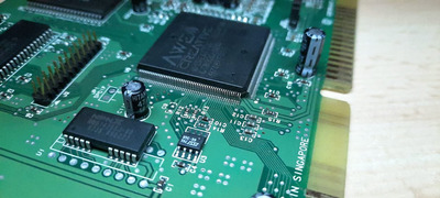

I have this CT4520 AWE64 ISA sound card that was giving me headaches for the past few days. After recapping it (noticed bad, uneven sound) it was behaving erratic.
I tried three different systems, two different OSs, and several various driver versions, but it did not work.
Finally today, I took a good look at it, especially around the main chip, and noticed some gunk, perhaps conductive, in between couple of pins - IPA cleaned it well.
After that, I noticed several loose pins, so fixed those, plugged it in and now it works!
PCM and MIDI sounds, and all...I am properly happy that I managed to fix it (fix a problem that obviously I caused at some time in the past) 😁

Nice job! I've found that bent or damaged legs on chips like those are the most common cause of issues with non-working devices I from the 90s.
