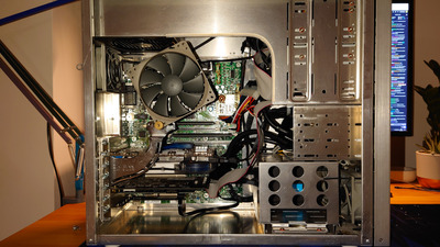

Tried to tame the cable anarchy going on in my OR840 system.
One hour later....
Slight improvement, but cable anarchy remains. Tempted to remove the SoundBlaster live drive if only to remove that ribbon cable. Would not care so much but the case I'm using has a Perspex window in the side panel

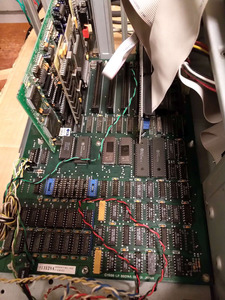

Turbo XT clone build. Installed XTIDE ROM (27C64) to "ROM BASIC" and that seems to work fine with random 16-bit I/O controller. It boots DOS 6.22 just for testing.
There is no support for HD floppy drives. Just wondering could I just burn XTIDE + HD-Floppy BIOS to single 27C128 ROM ?
EDIT: I answer to myself: You you can! Just joined XTIDE+Floppy ROMs and voila...

That's interesting, I didn't think any 16-bit I/O controllers would work with IDE in an 8-Bit ISA slot. Usually only Floppy works.

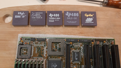

I got a Ti 486SXL in pga 132, AT LAST. This is the opportunity to see how it perfoms in comparison to its pga 132 counterparts.

The magic needed is 8bit IDE option in XTIDE build what forces IDE controller to 8bit mode. It needs support from drive, AFAIK only CF-cards and microdrives do. I tried couple of modern HDD - no detection.
Ah, that is interesting. I never tried a CF card with 8-Bit mode on XTIDE, I'll have to give that a go on my IBM XT & Turbo XT boards. I have about 3 generic I/O controllers so maybe I'll get lucky and one of those will work.

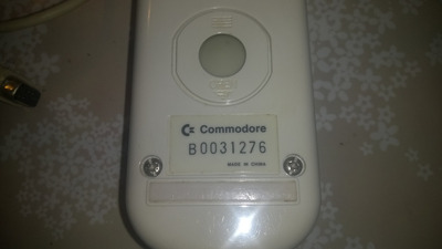

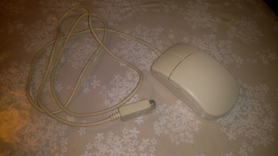

Found a recapper for my Amiga1200. Going to have it recapped with organic polymer caps, for minimum leakage in the future.
Also...
Fixed the mouse that came with the Amiga1200. I had to change one switch, then I was able to get working by having the other switch soaked in IPA. Cleaned the PCB with IPA and the ball plus rollers and sensors in IPA as well. The plastic shell was also cleaned in IPA. It is a responsive and heavy mouse, now working like new.

One longest lived switches I use to replace standard junk micro-switches in my favourite mouse is omron maker. Easily obtained from ebay, mouser (place your large order of components to cover the shipping and minimum order cost). And other electronic suppliers should have these.
