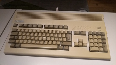

My new toy are finally working as new. I have had the systemboard to recap and there are now new organic polymer caps on it and then I bought a new keyboard membrane. I am still missing a new floppy drive, so I have borrowed the drive that are normally in my Amiga600 for testing. It ran perfect through every test in the program called Systest, and then I played half an hour of Cannon Fodder in AGA resolution. Works perfect. I have so far payed some 123 euro for membrane and recap and the machine it self was bought for 200 euro. The good thing, is that there will be no more leaking caps, and the machine will stop working the day one chip gives up and not because of leaking caps.
My plans for this machine in the future, is to get some kind of accelerator with around 32 or 64 megabyte of ram. Possible up to 128, however that seems like overkill. I just want an 68030 and FPU on this machine. Then upgrade the Kickstart to 3.1.4. I will need a scandoubler of some sort, internally that is. And then have one of those angled IDE-CF adaptors that have an 44pin IDE connector on it, for running a slave drive. The machine will be used for a writing tool, playing around with pictures, listening to MOD files and be an ADF to Floppy writing machine. No WHD-Loader, as I will be installing a Gotek solution. The ADF writing will be done on an external drive. I almost forgot to mention, that I will be getting one of those new cases that are being produced. Then retrobrighting will only be keycaps. That makes it all a bit easier, than having to deal with a full case.

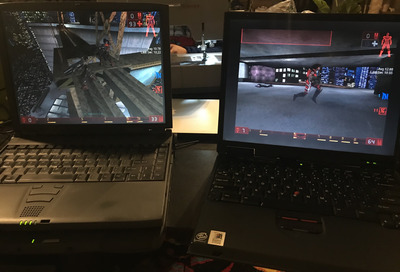

Toshiba Portege 7220CTe, 650Mhz versus the Thinkpad T21, 850Mhz - the Portege has the ESS Maestro 2e with Sensaura support in UT’99. The Thinkpad has the Crystal CS4264. Both are 440 chipset machines, Coppermine based with 8MB S3 SavageIX GPUs, which is okay for DirectX 6 but hopeless for later API revisions. Difference when running at 1024x768x32 in S3 MeTal mode? 2 FPS.
The 7220 CTe is also a bit larger than originally assumed, nearly the size of an Evo n600c or Retina MBP13 while undocked.
Note: on the S3 SavageIX, stick to 800x600x16bpp and Direct3D for playable frame rates.
1.32 MiB
1685 views
200Mhz and 2 frames per second difference?!

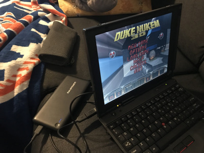

Got the Thinkpad 240 running off a 30w USB-PD power bank. It doesn’t draw enough power to be a danger to the electronics onboard. Having the ability to play games again while mobile? Definitely worth the hassle.
1.31 MiB
1685 views
PD Powerbank for your vintage machine

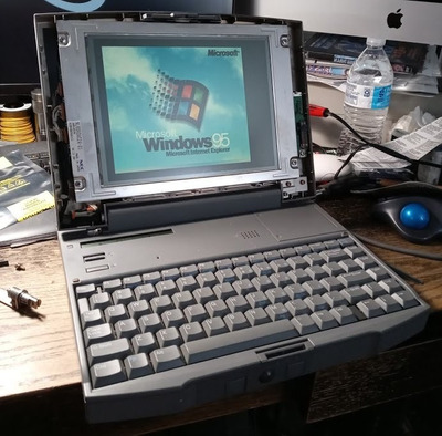

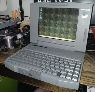

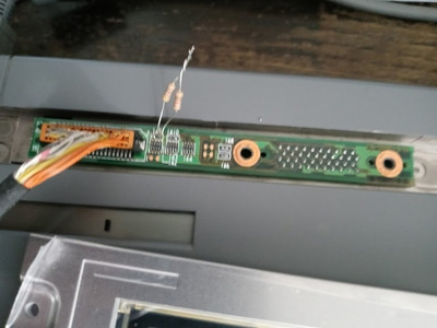

Finished up the NEC Versa laptops last night, now all are working. The only future plans are power supplies, hard drives, bags, and other boring stuff. I MAY do a project where I modify the battery to utilize USB LiIon batteries like those you plug into your phone - the charge output looks to be, per digital multimeter, almost 100% dead on. Definatley something for me to look at.
Did electronics wizardry to the M/75 and upgraded the screen from a 640x480 to 800x600. The input board in the screen hinge cover had an unpopulated SMD resistor place above one of the IC's that is present in my Versa P/75, so I copied that with regular resistors - it's a 1.5K Ohm - and BINGO, the N.O.S. 800x600 panel came right up nice and bright. The backlight was a little "yellow" so I put in the backlight from the dead NL6448AC30-09 and it's really nice now. I still kept the other CCFL backlights from my other dead/damaged screens so if I need one, I've got plenty of spares on hand, at least 4.
The 40EC was put back together with the 16MB card I bought 3 years ago and it's original NL6448AC30-06 screen. Booted right up and it's happy now. So now all four work, have working screens, setup HDD, and I have one working battery ATM....maybe two since I plan to try the USB pack experiment on the 40EC (that one has always been my guinea pig).

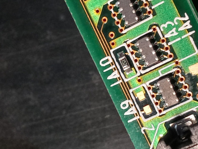

Finally, some blank EPROMs for XTIDE BIOS for my main project at the moment. Only verified they work and aren't fake. Was able to successfully blank check, write to one and read it back, so it's all good!
Picked a 27C128 series to use the larger version with menus and whatnot after padding.
