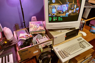

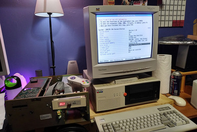

My SD Card to IDE, Gotek, and Bios Battery showed up this week, so I got my Zenith up and running. A big thanks to "PC Hoarder Patrol Offline" for the configuration software. All I had to do was boot up off my Gotek, and then run a file called CF and it made my Zenith a happy computer.
Setting up the SD to IDE was much easier on this 486 than my AT&T. It has auto detect IDE. The only hiccup I had was with the SD. At first I had a c drive, but I could not format it with system. After messing with FDISK, I ended up with a missing operating system error. Running FDISK again would not recognize the drive.
What finally worked for me, was to format the SD with RUFUS as a bootable drive in Windows 10. Then when I ran FDISK on it on the 486 again, it recognized the SD as a C drive. Then when I formatted it with system, that finally worked.

    This is the Zenith configuration software.

    Monkey Island to test the SB16 Vibe I bought the other week.

Great looking old PC's ! Good job !

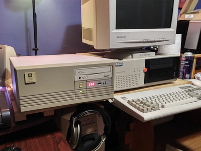

Thanks!
I hastily painted the front today and shoved in my 40x IDE CDROM Drive -- which I bought new stock a few years back for 5 bucks, so had fun unboxing it.
When I painted the front case, long story short, the parts were in a box next to my window. I should have known better, a gust of wind pushed the box off and caused one of the 3.5" plates to land on top of the main face plate. This left a mark, which I then painted over. No big deal though, it looks pretty good in person IMO.
Just to get the CDROM in was a chore. There was hardly any room between its back and the PSU. It took me about 15 minutes to figure out the right configuration for the IDE ribbon cable, so that it could also connect to the SD card drive and not hinder the plastic rod which is used to power on the PSU. I also had to factor in the Floppy cable, which was in the way.
To make things more difficult, he GOTEK's screw holes barely lined up with the case holes, and there were no holes on the left, just a rail slot -- I don't have any rails. I found some rubber fan spacers that fit, but not perfectly, but I managed to get it in fairly level. To add even more work, there was a large gap between the GOTEK and CDROM. So I found a piece of wood and cut it -- a tiny bit too short, then painted it the same color as the front bezel. It works, but I'm going to order some styrene sheets and make another attempt.
Anyways, I'm happy with it. Nice to finally have a more boxy case with lines. 😀

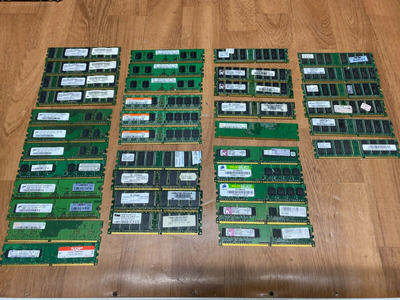

This batch of RAM arrived today, mostly for testing repaired motherboards.
In total there are 38pcs.
Two are 512MB Kingston 133 PCs.
For these I have to see in which PC to put them, replacing others of 256MB.
There are 4 PCS of RAM per server, they are from Infineon-IBM, it says 128MB DDR 133MHz CL2 ECC REG.
For these I don't think I have suitable motherboards.
Most other DDRs are 266 and 333, the capacity ranges from 128MB to 512MB.
For the 333 I have a Gigabyte with P4 / 533.
The rest of the lot is made up of DDR2 RAM, most of it is PC5300-667, a couple of 512MB Corsair, others Kingston and Micron, were mostly installed in HP PCs, finally 3PZ 512MB of the Hynix PC-3200 coming from an Acer PC .
