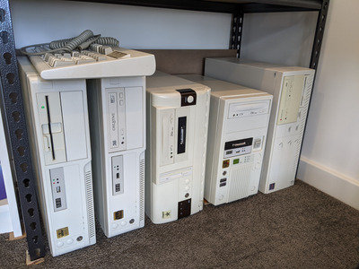

Interesting case. Looks like a full height version of the low-profile cases I have (the two on the left). At least, they seem to share a very similar design language. The one on the left is my 286/16 and the other is my 386DX40

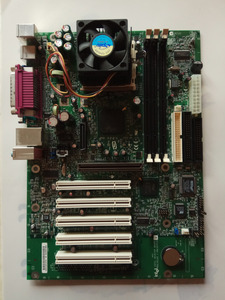

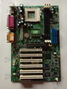

Prepped 2 Tualatin boards for incoming processors. Cleaned them up and flashed latest available BIOS.
One is Intel D815EEA2/D815EPEA2 and other is Epox EP-3PTA. Epox had about 10 caps replaced.

Are you sure that D815EEA2/D815EPEA2 can run Tualatin cpus?
My heart felt warmth 😀
That is beautiful. I wish I had some nice case like those.

There were several indications that this case is from 3rd quarter 1991, up to and including a sticker on the P/S that said Oct 1991. 😉 Original Seasonic power supply too (not a size I've seen before - width/length is the same as a standard AT/ATX, but about 2 inches of height added, as well as a physical switch out back) - I would not be surprised if these cases housed later 286 16-25 MHz systems in their product run.
Definitely a well-built case - heavy, well machined, good use of plastics, and sturdy design.

It was tested/flashed with Tualatin Celeron 1100 😉.
But yes, there were 2 versions of this board and the first one did not support Tualatin chips:
* D815EEA/D815EPEA
* D815EEA2/D815EPEA2

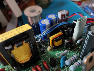

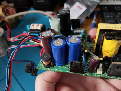

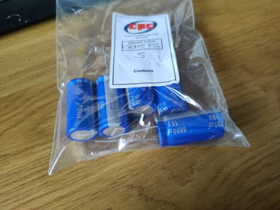

Fixed my whining Sharp X68000 power supply:

Upping the filter caps from the newly replaced 5600uF rated parts (every cap had been replaced by the seller, to original specs) to 6800uF components, along with a new Noctua fan has made it absolutely silent. So, the 'scene' recommendation of increasing the capacitance of those two parts was spot on.
https://www.youtube.com/watch?v=3c_ri0HJXPk
I am very, very happy.

Nice work and good info to know!
