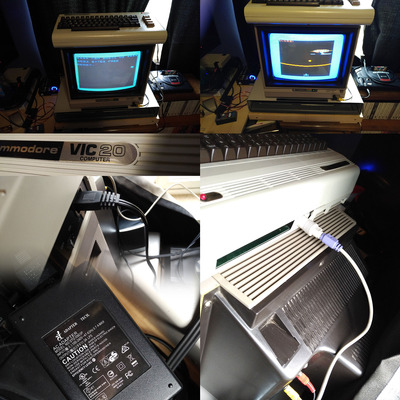

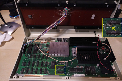

After much research, I finally got my VIC 20 working!
I cleaned it all up, brushed its teeth(keys), removed the dead moth I found on the inside, and frankensteined together a video cable and PSU.
The best part, is that the plastic on the Vic 20 gold label has not been removed. 😀 Overall the system was really clean, not much dust on the inside.
The PSU is a 9V DC 3A soldered to a square 2 prong plug I found. I learned that the VIC 20 will run on DC from this forum, and it runs cooler and will still power everything with enough amps:
http://sleepingelephant.com/ipw-web/bulletin/ … it=Power+Supply
The video cable is made from a 5 DIN keyboard to PS2 adapter, a PS2 cable, and a RC cable. The keyboard DIN doesn't wire through the "reset" pin, so currently there is no audio.
I'm going to make a new cable with audio later this month, and also consider doing the the Luma Chroma mod.
*EDIT*
My colors were all wrong on the VIC. I had to adjust the dials on the motherboard to fix it. Now my white background is actually white, and not dark gray.

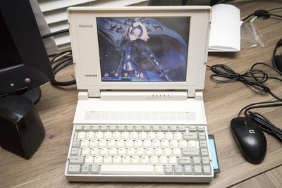

And completed restoration of the T4400C. Just need to get those stickers to stay better.
1.59 MiB
1392 views
And probably clean the floppy too. It likes to act flaky at times.

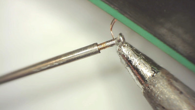

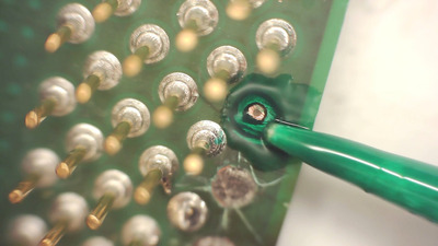

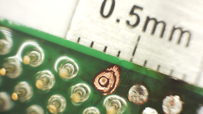

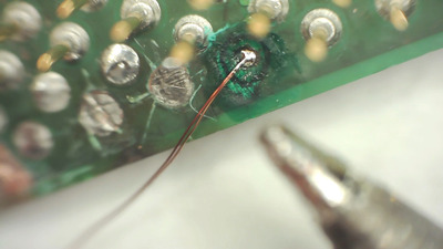

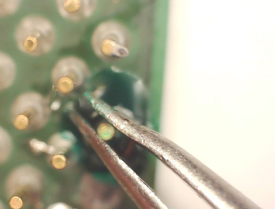

As a followup to recent pin soldering repair, I've been experimenting with broken CPU pad repair methots on a scrap P3 (cracked die, so won't be able to test) 😀
This is how I approached it:
besides of regular soldering stuff, microscope is mandatory, UV-curable soldermask is needed, thin as hair motor wire is needed (i used two of them in parallel), epoxy will probably be needed in the last step.
Broken pad can be scraped down to the internal microvia. VCC and GND planes will also be revealed, they need to be separated by scraping the surface and insulated with UV soldermask. Then a short piece of wire needs to be soldered between microvia and CPU pin (i trimmed it to around 6mm after soldering to one part). We don't want to directly solder CPU pin to microvia, because it would snap instantly. Then it probably needs to be glued with epoxy, didn't try that yet, but UV soldermask isn't good enough. I will try to also cover it with a 3D printed shim with holes for CPU pins to increase the strength further (at the cost of making pins a little bit shorter).
Don't know if it will actually work because that CPU was toast earlier (i ripped that pad afterwards to play around with it, it also has several desoldered pins - it was a 'donor' CPU). I want to keep the wire as short as possible to keep the signal integrity. I bought cheap Tualatin with broken pad and will try later to see if I am able to get it to work.

Wow! That is one hell of a soldering job good show. I'm lucky if I can get a 2 gauge lug soldered on to a 2 gauge wire. I really need to get better at soldering. I sure do hope you can get that Tually working again.

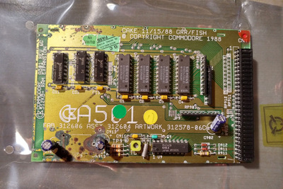

The Amiga 500's expansion card was corroded. Not sure if I have the skills to fix it, but I'm going to try. It's been cleaned up some, but still needs more work. Fortunately there was no corrosion on the Amiga's main board, only a tiny bit on the pins that connected to the expansion card, which was easy to clean up.

    Memory Expansion card.

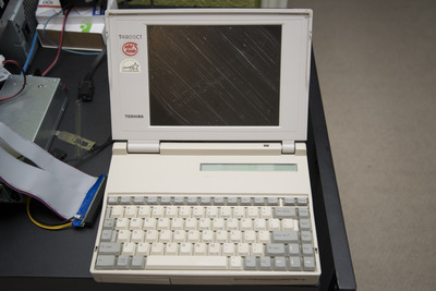

Next project arrived today.
This is probably going to be the most difficult laptop to restore. The seller wanted 250USD, however I talked them down much less than that.
Just looking over the documents and figuring the best way to tackle this unit.

That's a nice looking laptop. Is the screen all scratched up or just a weird artifact from the picture?
I have a laptop with the same issue, not artifacts 😉
Basically the glue that is between the lcd and the outside layer (protective?) alters in time and has a lift up/ bubbly effect.
There's a video on yt that explains removal and replacement.
You can see perfectly through but it's only gonna get worse in time.
If I'm not wrong of course.
PC#1 Pentium 233 MMX - 98SE
PC#2 PIII-1Ghz - 98SE/W2K
Reply 18658 of 27716, by yourepicfailure
Yeah, pretty much a form of delamination, but not the one that makes it non-functional.
Pretty much, if you can see the pixels underneath it's fine.
It just looks like Toshiba made a poor design choice with plastic cover on this panel, because the older TFT panels used glass over the panel.
