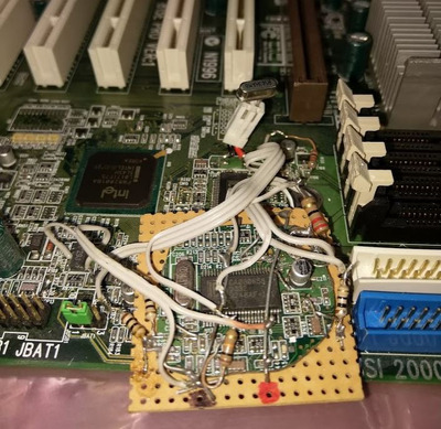

Reply 18681 of 27716, by fool
Some Pentium III Coppermine 1000 overclocking with MSI 815E Pro and ATI Radeon 8500 retail. Actually I didn't find the CPU max and hit the motherboard's roof. 7.5x166 is the max I can get from BIOS and it works without issues. I would guess this wont divide PCI/AGP clocks beyond 133. Now I understand why this MB had clock-mod when I bought it about a year ago (some in the picture below). It's been used in some serious overcloking by previous owner, nevertheless works like perfect. I removed all mods and tweaks, I like it more as original.
3DMark2001SE
7.5x133: 6117
7.5x166: 7427
+Radeon 8500 oc 300/300: 7618
This PIII really likes higher FSB and performance increase is significant. Too bad I could not find the max this time.

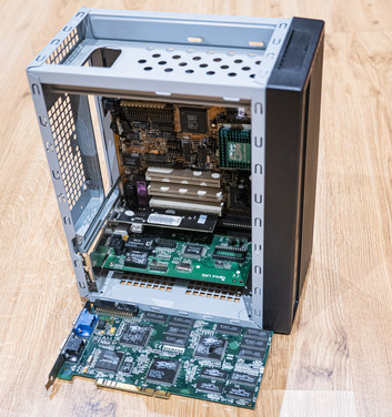

Reply 18684 of 27716, by adalbert
Trying to fit Zida 4DPS into ITX case. 3D printing bunch of adapters in progress. Bottom of the case was originally used for SFX PSU. Todo: fitting laptop CD and FDD drives and MHz display in space meant for 5,25" DVD drive (there is a spring loaded "DVD" flap in the front), making custom short cables and 3D printed backplate for IO... There is also a USB flap on the top, i want to put CF card reader in there.
Voodoo 2 for scale (too big to fit inside 😁).

7.5x166 seems like a pretty good overclock on a Coppermine!

Reply 18689 of 27716, by bofh.fromhell
adalbert wrote on 2021-04-11, 22:25:
Thats a Chiftec BT-02B if my eyes are not deceiving me!
Lovely little chassi, and way ahead of its time when launched.
A relative still uses my old chassi.
Now with an old i7-2700K, a tiny Quadro GPU, a slim DVD, 2 laptop HDD's at top and a large 2.5" SSD at the bottom.
And ofc the PSU has been replaced.
Tight fit, but it works =), I belive some of the scars on my fingers are from that very build!
Reply 18690 of 27716, by adalbert
bofh.fromhell wrote on 2021-04-12, 10:11:
Yes, that's it 😀 I removed PSU and will go with a Pico PSU for this mainboard, that way it is possible to fit some baby AT and micro ATX boards with 4 expansion slots in there 😀

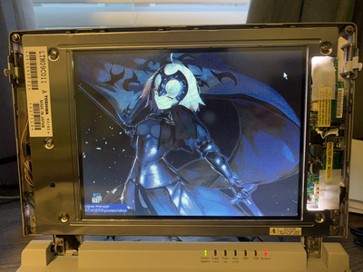

Reply 18693 of 27716, by yourepicfailure
Thermalwrong wrote on 2021-04-09, 00:03:
~snip~
Nice, always love seeing another classic Toshiba see the light of day.
My T4400 has a nice display, though it takes a little to "warm up." Once it does the colors are nice, sharp and the viewing angle is nice.
1.57 MiB
1626 views
The floppy drive also works, but if I stick the wrong floppy in there the belt starts slipping again. I should take care of that next time I go in there.
I only wish I could find a 32mb ram card for it. Because, theoretically, you could stuff a POD in there since it's socketed.
Unlike the newer 486 (and pentium 4900&4950) Toshibas that have soldered processors.
And a T4900, I wish I could find one. I'm only stuck with this 4800 that I don't have the time and money right now to fix up.

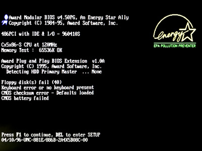

Reply 18696 of 27716, by appiah4
I like to live dangerously so I thought I would test a few things at once:
1. Biostar MB-8433UUD-A Rev 2.0 motherboard that would not POST due to a dead Dallas RTC, from which I desoldered the said RTC, soldered in a socket and socketed a DS12C887+ with a 2013 date code.
2. Untested IBM 5x86-100 (at 3x40MHz no less)
3. 4 sticks of untested 16MB FPM-72 memory
4. Untested PCI S3 Virge
Amazingly enough, they all worked.
226.71 KiB
1486 views
Shockingly enough, I appear to have gotten started on my Super 486 build..

One of those days when the stars align. Buy yourself a lottery ticket 😊

Shotgun approach. Pretty good considering the 25 year old hardware.
