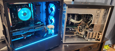

I recently replaced most of the fans in my dual socket rig.
1009.36 KiB
1530 views
1.23 MiB
1530 views
787.1 KiB
1530 views
Next on my list will be either completely replacing the power supply or just replacing its fans.
I have been a Lian-Li fan since about 2006 and held on to my original PC-65 case since I bought it. On the left is my newer Lian-Li LANCOOL II Mesh RGB. I am not a huge fan of RGB so they are likely going to be replaced with more Noctua. Here is my old case vs new.

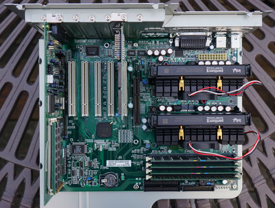

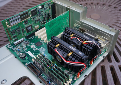

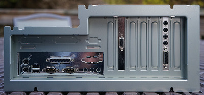

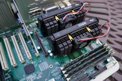

Building a new old stock vintage system, at no cost other than shipping, for a friend who's a member here and at VCF. He's looking forward to it.
NOS InWin A500 ATX Computer Case
NOS Supermicro P6DBE Dual Slot 1 Motherboard
NOS Intel Pentium II 300MHz x2
512MB RAM (128MB x 4)
13GB IDE HDD
Sound Blaster 32 w/ 32MB RAM
NOS Intel PRO/100+ PCI Server NIC
AOpen DVD Writer
1.44MB Floppy
The video card is a NOS 1MB S3 Trio64 PCI video card (exp 2MB). He can add his own AGP card if he likes.
Here is the beginnings of it on the InWin A500 pull out mobo tray:

Will it run a multiprocessor OS or is it just for the aesthetics? Either way fabulous!
Green PCBs; clean look. And I like the brass accent on the coolers. Maybe sleeve the CPU fan cables with something black. 😀

Is that 72 PIN memory on the sound card?

Nice! And Klamaths even .. That's gonna be a lot of heat 😀

Well, I'm leaving the HDD blank, but I think it's a great multiuse dual boot candidate of a machine. A little DOS/Win 3.1 so CPU #1 feels important and a little Win2K so CPU #2 doesn't feel lonely. I wish the brass was my idea, but those CPUs actually came from unused IBM CPU upgrade kits. The HSF was already factory installed and amazingly the thermal compound that is probably fossilized inside is doing its job in spades. I think the colorful electric wire coming from the fans is a nice splash of color, but then again I was never very caught up in vintage hardware interior decorating. 😉 Overall, I agree, I think it looks handsome for sure. Too bad it will be locked away in a case that has no windows, but I love me some InWin A500. One of my favorite vintage beige cases. If it only had a LED readout it would be a killer.
Jed118 wrote on 2021-04-27, 06:38:
No sir. Just your standard 30-pin. On another note, one of the cheap plastic memory clips snapped from age, but the remaining clip is holding it nicely in one of the slots. The entire memory mounting assembly is one piece so Luckybob directed me to a higher quality replacement that has metals clips. I will be shipping that with the system so the new owner can have a weekend project if they so choose.
H3nrik V! wrote on 2021-04-27, 09:35:
Believe it or not they idle at around 36C. Under load they only get into the 50s. The Klamath has a max temp of 72C from what I was reading. Maybe IBM put their secret sauce sandwiched in-between the HSF and CPU. Maybe it's peanut butter. Like I said, I didn't change the paste since they are NOS and the temps look really good. If it aint broke... Which brings up another interesting fact about the Supermicro P6DBE. After applying the last and latest BIOS to the board I went into the settings only to find a wall of text in potions (I mean options). I know it's a workstation/small server board, but it has a lot to contend with in there. I left most of it at default settings. I could not understand why the front 80mm case fan was not kicking in that I had plugged into the board's thermal fan plug. Appears this board has a built-in piezo thermal alarm speaker you can enable in the BIOS and you can set the temp threshold of when it should sound the alarm. According to the manual that is when the 80mm case fan will kick in to cool the system down. So I set the threshold to 33C and holy mama on a torpedo. That was seriously loud and made my wife jump into the ceiling, but hey, it worked and the fan kicked in. I would say that was pretty cool, but that's just me trying to be funny.

And 86w on the 5v rail just for the CPUs, when they're under maximum load. That's up there in overclocked Athlon XP land! 😜

Hi there - which PSU are you planning to use with that?
I have a dual Pentium III 1.4ghz Tyan board that I was trying to use but it seems like two Pentium III's need a very high amount of amps on the +5v rail and I haven't been able to track down a totally working PSU with enough grunt for it.

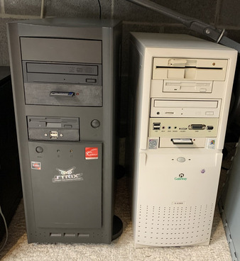

I finally got the all the face plates to match on the white tower and a dark gray tower case that I've had since 1998.
3d printed the CF plate and the USB plate. They were black gloss, but they match the tower pretty well after taking the sine off with some fine grit sand paper.

I have found with those late 90s Gateway cases the power buttons love to break and sink inside. It's the way they are angled and the plastic poles on either side of the power button gets plastic fatigue and tends to snap over time. There was a guy selling 3D printed power button replicas on Ebay for awhile and I bought a handful from him. No longer have the machine so the extra power buttons went with it. I posted about it awhile ago. Might be something to consider as a 3D print project down the road.

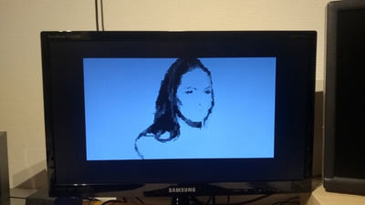

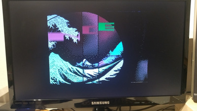

Watching some Demo's on Black Bessy. My homebuild SixtyClone 250466....
