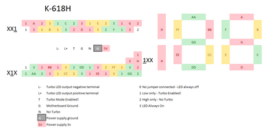

Urgh, I just spent what feels like half the evening re-learning how the K-618H turbo LED panel works. After finishing this, I checked another place I store documents and it was all in there, I did this back in October 2018.
So here's the K-618H turbo LED settings:

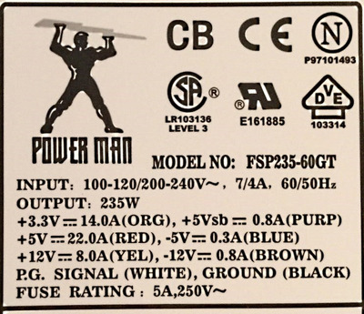

Any decent modern PSU can do the job. I use various models of Corsair gold rated PSUs. They have served me well with these builds. I am actually leaving the original Power Man 235W PSU in the case just because I think the logo and name is hilarious with the muscle man holding a lightning bolt.

I did my modern snoozer build in one of these In Win A500 cases. Replaced the original PSU with a Corsair RM850x for that Ryzen build. I did my Socket 370 vintage build with a Corsair SF450 SFX PSU coupled with a SFX to ATX adapter bracket. Why did I choose SFX on that build? Because it took up less space and left me some needed room in that area of the case. I do like to leave the original parts with any vintage case and let the new owner modify it to their liking. The 235W Power Man checks out perfect, but obviously will have to be replaced for a full load. Idling and light load DOS/Win 3.1 (single CPU use) it does just fine. Let me show you what I did to get that hot air out of that case and how I think the dual 300 build should go as well. Let's hop over to that modern build thread and I'll take you through the steps.

Power Man isn't that bad. In your case, it's a FSP underneath after all. 😉

heh. I'm really just leaving it in there as a joke. The new owner will most definitely replace it.
