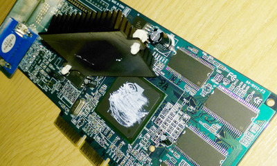

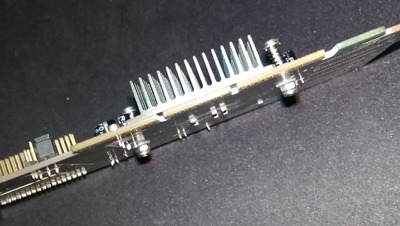

Today I repaired Gainward Geforce4 Ti4200. It was giving colorful pattern-screens and crashes during 3DMark2k.
Then I found this https://web.archive.org/web/20031104011507/ht … 15&pagenumber=1
It is a (old) known capacitor issue. Replaced 3x 1500uF caps with (overkill) Nichicon 1000uF low-ESR polymers. Removal of large SMD capacitors may be hard with an iron, but one trick is to GENTLY jiggle the capacitor with pliers until legs snap or pops out. After that it's easy job.

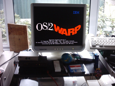

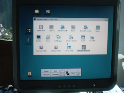

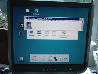

Been working on my AcerAcross 486DX2/50 system. Installed a DVD reader to access CDr/ws as Master on the second IDE channal.. Installed a second hdd, a Conner 406meg hdd as slave. Left the master 520meg hdd as fat16 for dos. Used Partition Magic to format the slave hdd as HPFS or OS/2. Installed OS2 v3 Warp Connect on the fat formatted hdd without network support as I'll install OS/2 v4 Warp Server OS/2 network client as that has a 32-bit tcp/ip stack and DHCP support which v3 Warp Connect doesn't have.
OS/2 v3 installed and was set up in 25 minutes or so from the DVD reader.. The reason I installed it on a fat partition is that I can switch between Dos and OS/2 without needing a boot manager. To boot to Dos I just choose the Duel boot icon the Command Prompts group. To boot back to OS/2 from Dos just type C:\OS2\boot /dos and press enter. The OS/2 v3 installation was less than 50 megabytes.
This system dedicated to os/guis except win9x

Interesting... I've got/had a GF4 card with wild behavior and inability to run anything without checkerboarding... if/when that turns up again, I'll have to check out the capacitors. Not sure it's a gainward, or a 4200, but it was 3 or 4 years after it was new, so maybe capacitor age/plague and a fuss was not raised because out of warranty a ways.

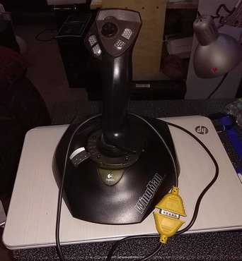

That's the Wingman I cleaned yesterday. Potentially late DOS all the way up to Windows 10, though it will probably go on a Win98 system.
