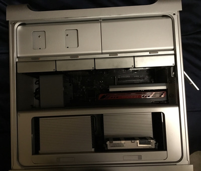

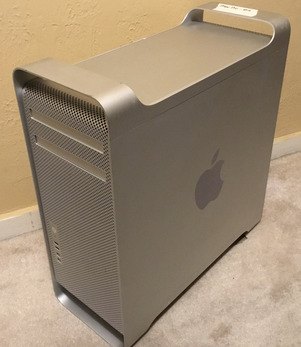

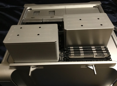

Working on my “Home Theater Media Center NAS” computers.
I have two 5,1 Mac Pro’s I have loaded with large hard drives and SSDs
I added Wifi cards and upgraded the CPU’s to Dual Six-core Xeon x5675’s @ 3.0-to-3.4ghz
For a total of 12-cores and 24-threads each.
It only costs $50 for a pair of x5675 Xeon CPU’s
They perform very good now.
Very snappy and responsive. I definitely notice the difference going from dual quad core xeon’s to dual hex core xeon’s.
I did not think the difference was going to be that drastic but it is.
But these where a pain to upgrade. Apple design is NOT very friendly for upgrades.
It’s definitely NOT a tool less design case.
I had to de-lid the CPU’s too.
Working on a PC is much easier.
But NO home theater is complete with out a Mac in it.
Eventually, I will replace these with M1 Mac Mini and a Disk array.
They use less electricity.
The Mac Pro’s use about $40 of electric per year in power saving mode.
The Mac Mini with disk array should use about $25 per year in electricity
But the large disks are too expensive right now. Maybe upgrade later when supply and prices
Are more realistic. I would like to use a Disk array with large capacity SSD’s.

But by god, those are such beautiful beasts inside and out. I still have my 10-year old Mac Pro 5,1 chugging away running Mojave in my studio as my office mainstay. It may be time to do a fresh install and try getting Big Sur running on it but it runs really well as is. Specs are:
- Dual X5680 (3.33Ghz, 6-core)
- 64GB RAM
- 480GB Kingston HyperX PCIe SSD
- 8TB WD Gold
- MSI Radeon RX560 4GB
- Sonnet Allegro 2-port USB Type-C 3.2
I love how these are still going strong after such a long time. I don't think I've ever had a hardware failure - touch wood!

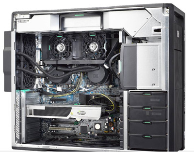

That’s why these were so popular with the Mac community. They are designed some what like an IBM Open Architecture PC.
These were actually made to be repairable and upgradeable unlike most Macs.
But these are still NOT as nice as an HP Z-Class Workstation which are in a tool less case.
I like the Z-class but that photo only confirms the theory that Apple continues to design computers that look as good on the inside as they do on the outside. Not a fan boy here but I value good product design. Apple are superlative in this regard.

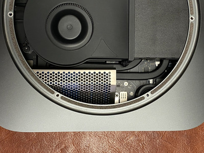

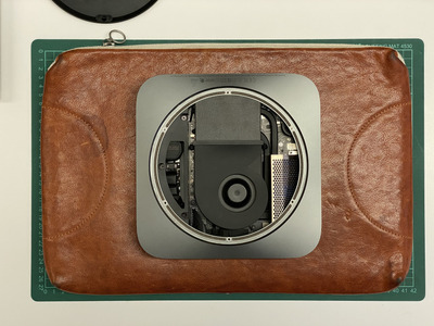

Completely off topic here but one example is my assistant’s Mac Mini from 2018 taken apart to upgrade it to 64GB RAM. You can do this with almost any Apple computer from the last 25 years and always have something to appreciate about the way it’s been assembled and individual components refined over their PC brethren.

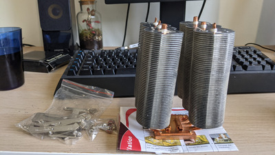

Very nice machines indeed, superb build quality and design. I used to own a 4,1 which I flashed to a 5,1 and upgraded with dual hexacore Xeons, 48GB of RAM, PCIe SSD, USB 3.0 and a Mac-flashed HD7970.
I also de-lidded the CPUs with the vise method. Kind of scary, but it worked surprisingly well.
But since I have always been more of a Windows guy and used the Mac rarely, I decided to sell it while it still fetched good money.
Yeah, It looks difficult to do but it is actually very safe and easy. These Xeon CPU’s are built very tough, So they don’t bend or warp very easy.
Just stick the CPU in a Vise, Clap on to the LID on one end of the vise and gently squeeze on one end of the CPU then turn the CPU the other way and gently squeeze on that end and the LID falls right off. Surprisingly It takes very little pressure in a vise to remove the CPU LID.
I was going to buy the de-lid tool but I was not sure which one would fit this Xeon CPU.
So I know the Vise method would fit the CPU so I decided to use the Vise method.
Its basically the same principle of squeezing on the edge of the CPU LID to loosen it so it falls off.
And I only had this one set of CPU’s to de-lid.
I don’t plan on doing this again. I hope.
I don’t know what the material is that Intel used to adhere the LID to the CPU but it gently scarps right off with a razor blade.
It only took me about 15 minutes to remove the LIDS and clean off the CPU’s.
