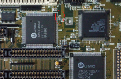

I was investigating this board that i have (MS-3131):
https://www.ultimateretro.net/en/motherboards/1389
Based on chipset's datasheet, it should support writeback for its cache. But i never got it to work.
I used AMISETUP and CTCHIP34 to look into chipset's registers, but couldn't find much about writeback.
There's MR-BIOS available for it as well, but that as well didn't enable writeback.
Then i took out the chipset's datasheet once again to check the pins from the chips. And what i see is that alter bit lines are fixed to 5V through resistor.
So natively, no writeback support on the board itself.
But theoretically, if one would remove the smd resistors and instead does some modding and piggyback with additional cache chip, it could be doable... but that's not for me. I have an amazing M-321 board, that does writeback very nicely and i'm happy with that.

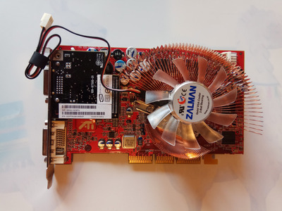

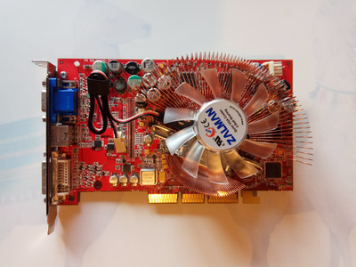

New coolers for FireGL X1 and Radeon 9700 TX:
1.25 MiB
1338 views
1.03 MiB
1338 views

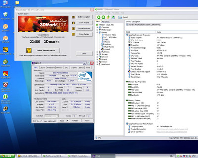

9700 TX appears to be a "golden sample" chip:
209.26 KiB
1338 views
Artefacts start appearing north of 410Mhz, in most cases with R300 limit is ~380Mhz.
Regarding infamous "yellow goop" TIM originally used on those cards, it depends how much the card was used. In one case it was totally elastic and went 100% off with just some pre-heating and IPA. In most cases it's solid and takes hour or two to get it off using heat, WD-40, nitro thinner, scraping with razor blade ... etc.
Reply 20604 of 27521, by TrashPanda
where did you get the replacement coolers from?
All I can find that are similar are no name coolers from china for 10 dollars each, I guess a tenner isnt bad for a cooler that looks similar to the Zalman ones but I want some better quality ones for the rarer cards I have.
Reply 20605 of 27521, by stef80
They appear on eBay from time to time in bulk quantites, new old stock. I bought few from Dutch seller. I think he had like 30 of them, 15€/piece.
My experience with chinese coolers is mixed. Smaller ones with push-pins vary in quality. Out of 4, two of them rattled out of the box. Fan was not centered. Bigger ones have wide flat base, which is not ideal for ATI chips with shim on.
