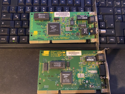

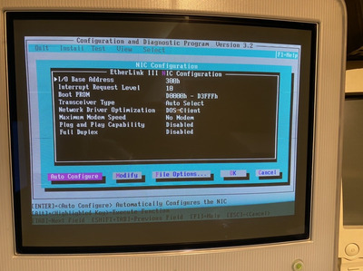

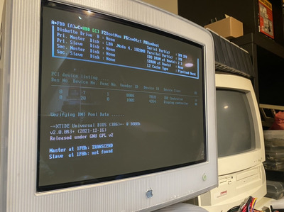

I made some XT IDE cards with my 3com 3C509B ISA network adapters. One with 8-bit ROM and one with 386+.

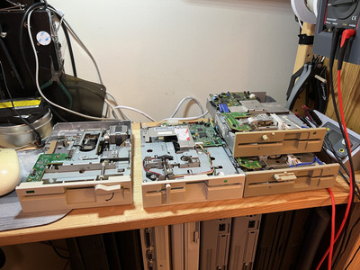

This isn't of much help to you I guess, but I was previously trying to do alignment of one of my 5.25" drives, by doing reads / formats of known good disks, it's tough. I had messed up the track-0 alignment on my Teac FD-55GFR by not realising the drive's main PCB had that sensor and was factory aligned. Somehow I did eventually get the alignment 'good-enough', but it was just guess work and lots of trial and error. I wasn't sure if the drive really worked properly.
Then as I mentioned the other day, I got a working 1.2MB 5.25" drive with its factory calibration intact. This Samsung SFD-560D needed the broken disk clamp cam replaced with a 3d printed one before I could use it 😀

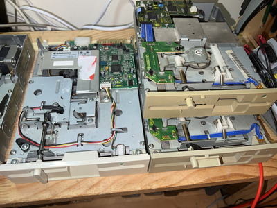

I was able to compare results using IMD / ImageDisk's alignment tool. Imagedisk can step the head over all tracks and you can see in realtime how good the read quality is from each location. This video covers how to use the tool really well: https://youtu.be/VZ9xhFkHZ5c?t=525
It's really impressive, I was able to check that the disk formatted on the Samsung could be read on the Teac and vice versa, across all the tracks. Which means I can now read things like the 5.25" cover disks / games, and the two drives can read files moved from one drive to the other, all the way across the disk.
If there was a way that you could run Imagedisk on that drive / laptop, you could check whether it can step to each track and whether it can read well at each of those tracks. If the drive was disassembled, in some cases the track 0 sensor / motor position could've got out of calibration, so it'd need to be re-done. It's less tough to get right than I initially thought.
I've got a total of 4x 5.25" drives and they've caused me a great deal of frustration, since I only buy the ones sold 'for parts' rather than tested.
2x are very similar Toshiba drives - the ND-08DE-A (FDD6782) and ND-08DEG-A (FDD6784). One has a problem with the bottom head, the other didn't seem to have a working upper head. I had inadvertently ruined the track 0 alignment on both. It took using the IMD alignment tool to really work out what was going on, since it can switch the head it's reading from as well as move tracks.

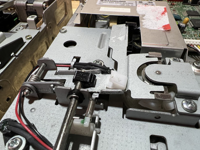

So I transplanted the less damaged front panel & the top head across onto the newer of the two drives. It didn't take more than a couple of hours to get the bottom head, then the top head properly aligned so that it could read across all 80 tracks. This isn't perfect since this wasn't an alignment disk, just a known good 5.25" DS/HD disk formatted on the known-good drive. But it does work!
Something else I did on the Toshiba drives was replace the electrolytic capacitors, they'd leaked and corroded nearby traces. I think any drives over 25 years old may have bad electrolytic capacitors and are worth checking.
So now I've got 3x working drives - they need installing in PCs, I didn't really intend to have so many but sometimes that's what it takes to get things working. I'm really happy that they're not just decorative any more 😀
