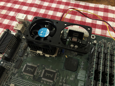

Since I don't plan on frying eggs I made a bracket for an additional 50mm fan next to cpu cooler, for cooling the voltage regulator.
Screw holes are too small at 4mm, of course. Will be fixed tomorrow.

Nice, I've got the same board I think TC430HX? That regulator gets toasty so the extra fan is a good addition. I think I screwed a 92mm fan over both the CPU heatsink and regulator on mine.

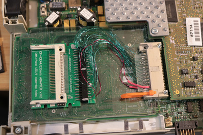

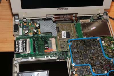

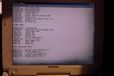

I finally got my Compaq Armada 7350MT back into a functioning state! Compaq hardware is so weird and I kind of like it for that - it needs a special partition on the hard drive just to load the BIOS setup. It's been such a long road to get this thing back to functioning, first I had to:
- rebuild the casing since this thing is 1997 plastic and that didn't hold up well
- find the rather unique power adapter, only used ever by the Armada 73xx and 74xx series
- troubleshoot RAM faults, it refuses to boot with most of my EDO 144 pin SODIMMS
- fix the LCD screen, the connector for inside the LCD panel, for its column driver had popped unplugged = just displays mess - man I was happy when I got it working though, the LCD is a weird 12.1" parallel AA121SB12 and those are not cheap to replace
- reverse engineer the hard drive connector's unique pinout: Finding pinout for Compaq 50-pin HDD connector on Armada 7300 series Eventually I got an Armada 7400 with the caddy to complete that, all working now including DMA!
- found out the LCD has this really weird thing where some sections of the display lose detail after it's been running a while
- battery is not charging, oh well. Maybe I'll fix that, maybe I won't.
- The super unique folding down keyboard is all working
- The wavetable audio is working great! the speakers are quite good on this old thing
So as it stands, the screen gets a bit unusable after an hour or so of usage and I can't go over 16MB of RAM right now but I'm so happy this thing is functioning again 😁
TC430HX Yes. 92mm is the sensible choice but these 50mm screamers are part pf the experience.

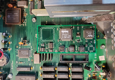

Tested out my recently acquired I-O Data PK-X486S50-3 (286-to-486 upgrade).
I had originally hoped to use it in my Tandy 1000 TL/2, but it won't physically fit on the motherboard due to the location of the 5.25" drive bay cage.
Fortunately it does fit in my Tandy 1000 TL and appears to work with what I'm assuming is a default base clock of 16 MHz.
There are a series of four dip switches on the board, but I have no idea what they do and haven't found any documentation on them. Initially switch 1 was set to on, but the system wouldn't boot. Setting them all to "off" allowed the system to boot.

Would one of those work on a Tiny-Turbo 286 upgrade card for an 8088 machine? I have one of those in my IBM 5150. The 8Mhz 286 is already a massive improvement and is very stable and compatible, even with the CPU on the end of a ribbon cable (LOL)... but I'm not sure if 486-level CPU performance would provide any real benefit for such an old PC. I feel like I've seen this done before, but I don't know if it involved this exact combination.

No idea if it would work with a Tiny Turbo. But in both these setups (5150 or Tandy TL), I expect the underlying XT architecture to be a significant bottleneck.
