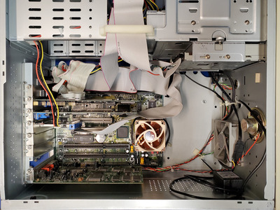

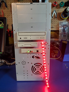

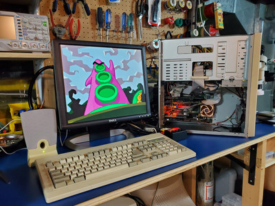

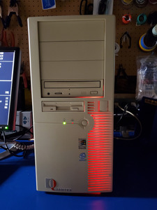

Continued to work on my Pentium MMX 200 build.
Got everything more or less installed. Tried to do some cable management, but there's only so much you can do with ribbon cables.
I also experimented with installing an RGB LED strip. The grill on the front has gaps for airflow, so I thought it might look interesting lit up. It does make it look a bit like a space heater, although the effect is more subtle in person.

I think it looks pretty neat! Only thing is, if you could shield the light from shining out around the drives?

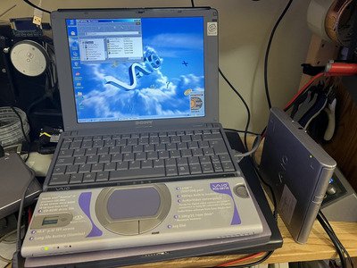

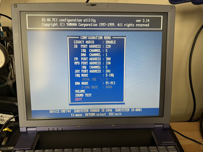

The other day I tripped over one my Sony VAIO laptops and felt bad that I hadn't done anything with them - a PCG-Z600RE, a PCG-Z600TEK and PCG-SR11K. Each one didn't come with a hard drive and has had a half-hearted attempt at getting software working, with limited success.
I've had a couple of days to spend on them and was able to piece together a working dual-boot of Windows 98 SE and DOS.
507.61 KiB
1715 views
Now they've each got:
  • Mostly working drivers in Win98 (except USB memory stick, oh no)
  • JOG dial working
  • Hotkeys working
  • DS-XG MIDI in Windows with digital audio in DOS-box
  • OPL3 music in DOS with digital audio thanks to cyclone3d's DOS drivers
  • CD-ROM support in DOS since the VAIOs have some BIOS support so the DOS PCMCIA driver is lightweight

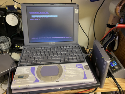

526.02 KiB
1715 views
I'm thinking that perhaps I should put together a post on how to do it along with the driver pack I've put together, and the boot floppy for CD-ROM support since the documentation for that is really lacking. I was getting so very frustrated with this yesterday since I couldn't get SETUPDS to work right in DOS, but today I seem to have had better luck.
I don't think this would be possible if I didn't get a bunch of Windows Me drivers on my PCG-SR33K. From what I can tell, this setup should work on all of the PCG-SRxx laptops (not PCG-SRXx), PCG-Z600NE/TE/RE/LE (or Z505 in some places but not all Z505s have Yamaha YMF744 audio), along with the Picturebooks that have Yamaha sound.
The key to this was the 2nd recovery CD for the PCG-C1XD on archive.org, it has application software for the Hotkeys & DLLs and it doesn't do a machine check, so most of it will work with later models 😀

Thanks!
I agree, shielding the reflected light is something I'm going to look at doing.
It's not too bad when looking from an overhead angle, but it does look a little odd when head on.
Should be pretty easy to address.

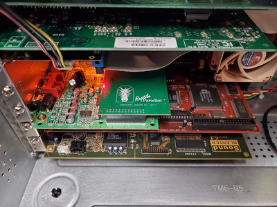

Spent the evening adding some audio options to the Pentium MMX 200 build.
Initially started with an AWE64 Gold and Roland MPU-401 AT w/ wavetable. Then decided to be brave and threw in a Gravis Ultrasound Extreme and configured it for Sound Blaster Pro support.
To my complete shock, everything worked.
I don't understand how or why, but having tested a couple dozen games, every single one has worked with no fuss. Even older games with basic Adlib/SB support all worked just fine.
Some of the auto detection is a little odd. For example, Wolfenstein 3D uses the AWE64 for digital sound effects, but the GUS Extreme for music and FM effects. But with everything running through an external mixer, as long as sound is coming out of the speakers it's all good. 😁

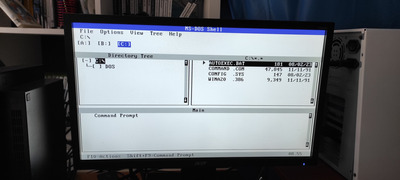

Made a 386SX build.
Unfortunately, the HDD does not work so I have to wait the new one I've ordered to install MS-DOS 5.0
I will also buy a CRT monitor for it, like this IBM

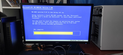

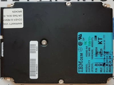

Got the working HDD (a 342MB IBM).
Installed MS-DOS 5.0 on it

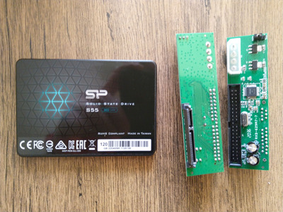

I suspect the hard drive in my W98 PC started to fail. After a fresh install it runs fine for a couple of weeks then the files gets corrupted on it.
Got a new SSD and a pair of IDE adapters, booted up Linux to format the SSD, set up an 80GB drive for the stuff I'll actively use and a 40GB one for drivers and stuff.
1.1 MiB
1521 views
Probably won't get around to set it up properly until Saturday. Hope it'll do well.

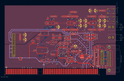

First "complete" prototype of my sound card how componts settle. This is just a very basic design with CS4232 + OPL3 and RCA outputs. Nothing extra I think I don't need.
There is maybe room for on-board RAM/ROM wavetable synth like SAM97xx, but perhaps I'll leave it like that for now.

Well, I thought I at least try and install W98SE, but it has been nothing but trouble so far. The BIOS detects the drive, but W98 installer says it has bad sectors. Reformatting using XFDISK, Partition Magic, or more modern versions of Windows were a failure. W2k can delete and create new partitions, but fails when it tries to format them.
Is there a specific BIOS setting that these adapters need, or my motherboard just happens to be allergic to something?

Some motherboards apparently don't like SATA to IDE adapters which use the JMicron chip. You might have better luck with an adapter which uses the Marvell chip, but those tend to be more expensive.
Sometimes, setting the "IDE HDD Block Mode" to "Disabled" in the BIOS can help. But if your motherboard doesn't like JMicron chips, it probably won't do that much.

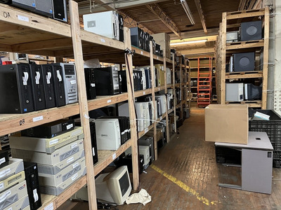

I stumbled into the Summit County E-waste facility.
They have racks of restored computers & monitors and a work room for doing computer repairs.

restored computers, so not for e-waste or recycling?
I wonder where they are destined for, if for schools or other facilities then the tech requirements are usually higher - to be able to run win 10 or linux mint and have the ability to go online and so on
that would make them all around 2010 or later

Wow, cool! I'm about 3 1/2 hours drive from there, one way... would you say is enough of a gold mine to be worth the drive? Or is it one of those deals where they look everything up on eBay and charge you basically what you'd pay for things online?
I really want to go digging through PC junk looking for treasure, but I have yet to find any large scale operations like that near me. 3 1/2 hours one way isn't exactly what I'd call "near", but it's better than 30+ hours.

I see a lot of beige in that picture. No way they're using these for modern OSes.
