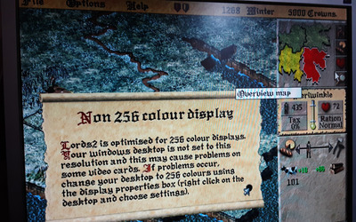

Set up MS-DOS 6.22 and Win 3.11 on a CF card via a IDE-to-CF adapter and optimized the memory usage — had to avoid loading a few things high so that MSCDEX can fit into the high memory area, and replace OAKCDROM with VIDE-CDD - 610K ought to be enough for most content I plan to run.
This now allows me to „dual-boot“ Win98SE and DOS 6.22 on the same machine with just swapping out the CF card. And some games (e.g. WCA) actually work better in pure DOS.

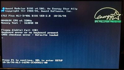

Finally had a big breakthrough while repairing an extensively battery damaged 486 VLB board a few days ago, so still gloating about that..
Reply 24532 of 27687, by ediflorianUS
appiah4 wrote on 2023-06-20, 10:17:
Good for you , Great even , I did this a while back. (I just used solder to repair the trace and some laquer on top of it).

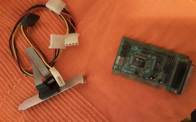

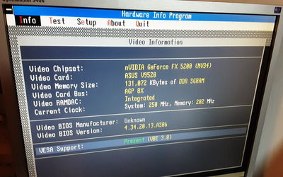

L.E. Finaly found my long lost Floppy Controller... for the 486s project....
& Testing a recaped Asus GeForce FX5200....

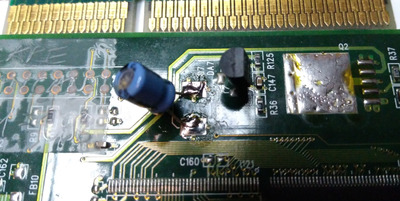

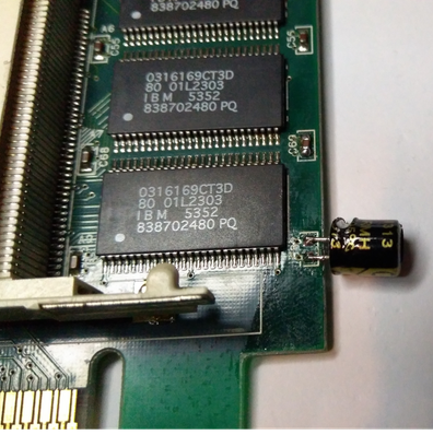

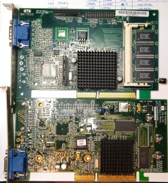

I resoldered a couple of caps on two video cards:
1. Diamond Savage 4 -- now OK, is picked up and dsiplays correctly, small stress test passed.
2. Matrox G200A -- gets picked up by OS but no video output. I replaced a small 100µF smd for ram with an electrolytic.
HWiNFO32 reports that its status is AGP 2X @ DISABLED
EDIT: HWinfo reports Video Memory: unknown ----> I need to find why. If a cap was 80µF when I tested it, could it be that all these need to be replaced with new ones? the ones close to ram chips, smd.
No ram, no video output and that's it.
BTW I had to chang m/b because the one I was testing with actually now behaves strangely + hangs on bus scan.

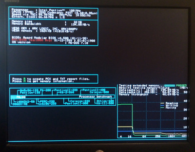

Had a go at overclocking an Ark Logic 1000VL. Finally got the VESA memory speed over 40.000.
Is it normal that it shows up as a 1000PV?
