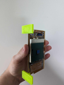

Made a Slot1 slocket adapter holder since all the brackets available don't grip them properly and the slight movement can cause system to crash
Fits great, works great, happy!

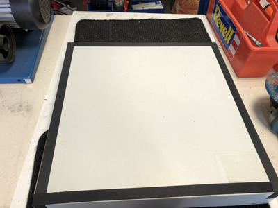

I started by masking the area i want to remove...

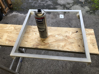

Then i filed the edges and masked off the original paint and sprayed primer on the cut edges.

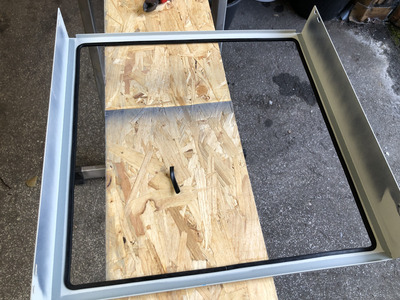

I put a small rubber seal around the cut edge

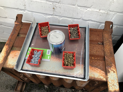

And i used super strong automotive window glue to prevent the rubber seal from falling off and hold in the new window in place.
(The protective film on the window took off all excess glue and its a super tidy corner now. Not kept the mess in the picture.)

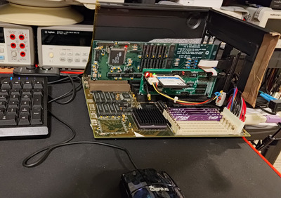

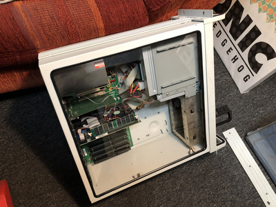

The result:
1.91 MiB
1573 views
If you dont know it, this looks like a factory option.
Now you can see the PISA SBC in its huge backplane.
I seriously like how it turned out. And tomorrow i will build another one!
