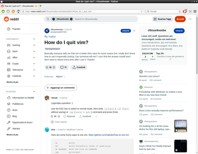

Did some cleaning on my PS2 and Xbox360.
Moreover, after updating Arch Linux on my Pentium 4 build (dual booted with Windows XP), I finally discovered a lightweight browser which does not hang the PC and can display modern web pages properly: Falkon by KDE

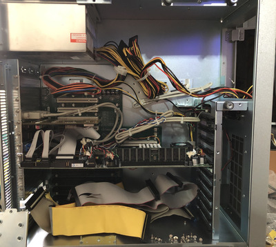

Thanks.
Already working on the next one 😁
1.84 MiB
1530 views
At the moment i reroute the cables, do some small fixes and make it look nice from the inside.

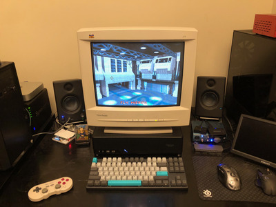

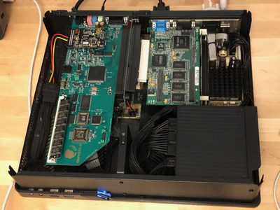

Built a system using the otherwise empty Node 202 that I've been using as monitor stand for the past little bit.
1.2 MiB
1428 views
1.28 MiB
1428 views
Overall, really happy with this lil guy. I decided to stick to DOS 6.22 for this one, but man - it's been a while since I've tried to live without FAT32 and I'm just not sure its worth it. Hmmm.
Reply 25569 of 27680, by BitWrangler
You just have to make strnuous efforts to keep your filenams constrnd to 8 charctrs.

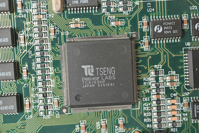

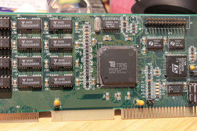

Today I realised that I'm never going to find a spare Tseng ET4000/W32P chip available and I have to use what I have. I bought a broken Genoa Phantom 32i 8900VL card, probably from someone on here 😀
It started out looking like this:
411.38 KiB
1323 views
Now it looks like this:
1.34 MiB
1323 views
It's had a bad time. This is my second attempt, the first was a few months ago with the dremel and using enamel wire I rebuilt the missing chip legs. It didn't work and just made some noise on the display when I tested it so it went back in the box.
A few months later I thought I had sourced an undamaged chip but no, I had mis-remembered and bought a TC6167HF. This is a TC6169HF - not compatible at all and the pin counts are very different, but I guess this means I can test them both now heh. The TC6167HF is attached to a compaq 486 motherboard that I bought as scrap and it's rusty on the ports area, but works just fine after reinstalling one missing jumper and straightening 2 chip legs.
So today I had another go at installing this chip, pulled it off the card again and removed all my original leg repair wires. Took it slower this time and used the microscope to re-align all the chip legs as they were all over the place last time. This time around instead of using enamel wire, I've used single strands of bare copper wire from a mains cable. Much easier to work with and this time the card booted up with no graphical glitches, that is awesome.

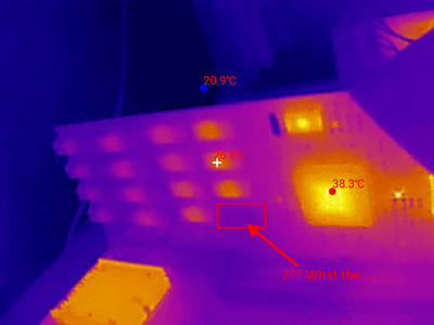

It could only see 512KB of its 1MB of RAM though, briefly checked some of the important data pins and thought to use the thermal cam to check for a short or...
186.83 KiB
1323 views
Thermal cam ftw 😁 The SOJ ram in the lower right, its VCC pin was no longer connected to the board and was probably bashed off the same time this ET4000/W32P chip originally got dislodged, soldered that back on and now it can see not 1, but 2MB of RAM (borrowed). I'm so glad, I wasn't in the mood to do 2 complex fixes today.
Anyone know of good part codes for DIP20 256Kx4 5v memory with low latency? Looks like the DIP version of the original is the way to go with V53c104HP-45 chips

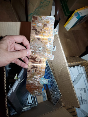

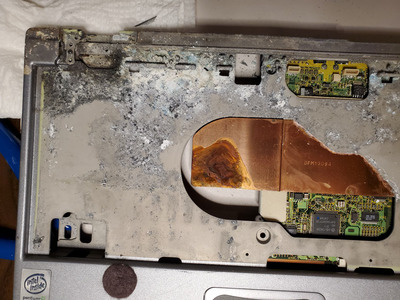

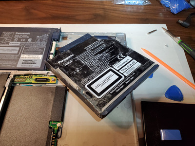

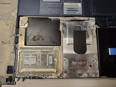

I have this same problem. I love vintage laptops but I have way way wayyy too many. It's shocking how quickly they can pile up in collection and how much room they actually take up.
I have a habit of refurbishing them as soon as possible, so once they inevitably enter long term storage, they are more or less complete enough to grab and go. However, there are some that I have been trying to restore for over 20 years, due to a lack of parts.
I ordered a unit off of eBay for parts this past month to fix said 20-year old laptop and it looks like it went through a flood... of course, all of the conspicuous angles were excluded from the listing, such as the rear I/O ports. I had to literally break the plastic apart to disassemble it to get at the motherboard, which I then dunked in vinegar to try and salvage it. It was very gross.

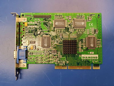

After feeling how scortchingly hot the Riva 128 chip on this Diamond V330 video card gets, decided to add a heatsink. Just in case.
