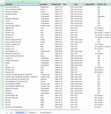

Been working on a database (really just a spreadsheet) of hardware with release dates. Intending to use this for guidance on some period-correct builds I'm undertaking from the 1990s.

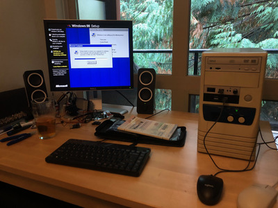

Another day another Windows 98 install~~
1.54 MiB
903 views
(was going to say "Installing off original media as God intended, but then I remembered back in the day I used to have FORMAT C: /Q; D:\WIN98\WIN98\SETUP.EXE on speed dial 😛)

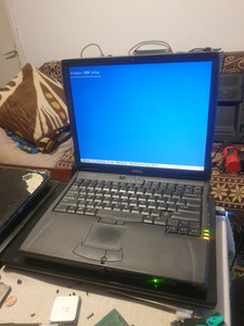

Good ole C600 getting some 2k treatment 😀
Planning to get BWC's extended kernel in there so I can add Java 7 or 8.

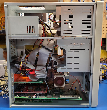

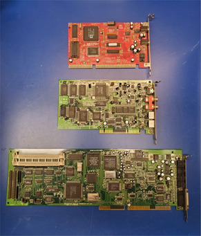

Modified my 1995 Pentium 133 build by swapping out the AWE64 and GUS Extreme and replacing with 1995 era-appropriate AWE32 and GUS ACE.
Also needed to swap the motherboard in the process as the previous one would not accommodate the AWE32's length.
