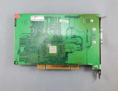

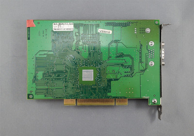

Started diagnosing this non-working Voodoo3 2000 3000 PCI.
1.06 MiB
943 views
719.55 KiB
943 views
It had a bunch of tiny scratches on the back. Nothing too serious looking until I found one broken trace.
Now to figure out the best approach to repairing it...

Shponglefan wrote on 2024-02-08, 22:59:
Doesn't look too difficult, boring would be more appropriate.
Scratch a bit more, flux, tinning, copper wire, solder mask. Done. 30 to 45 mins IMO.
Unless you do 1 trace, that'll be 10 minutes max.

Reply 26683 of 27649, by Shponglefan
Nexxen wrote on 2024-02-08, 23:51:
The difficulty is trying to make the repair as invisible as possible.

Reply 26684 of 27649, by Nexxen
Shponglefan wrote on 2024-02-09, 00:08:
Running a wire isn't super difficult, but it's more noticeable. I want to attempt running a replacement trace and then masking it so it's as unobtrusive as possible.
That is quite a trick you are trying to pull. In my experience the issue is to position exactly another flat trace on top of it.
This requires a donor trace, and the tiny thing ain't come off easily and neat. I only succeeded with big ones.
Or you could use a copper wire flattened and cut to required width. Visual impact would be minimal.
Please, post a pic when done. This is interesting for future repairs.
Good luck!!

Reply 26685 of 27649, by Shponglefan
Nexxen wrote on 2024-02-09, 00:59:
I thought about trying to use a donor trace, but like you say, it's hard to cut them out and have them remain straight and intact. These particular traces are only 0.13mm wide.
I have some circuit trace in spools, but the narrowest I have is about 0.25mm.
What I'm thinking of doing is first covering the exposed traces with solder mask, then exposing some copper on either side of the broken trace and running the replacement trace over top. It's going to be thicker than the original trace, but I'm hoping won't cause any issues. The biggest concern I have is inadvertently bridging a couple traces together.
Good luck!!
Thank you! I'll make sure to post a pic of how it goes.

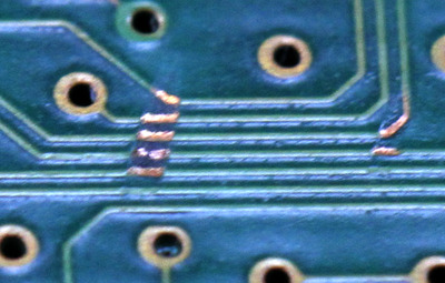

Reply 26686 of 27649, by Shponglefan
Voodoo3 repair successful!
845.96 KiB
837 views
173.49 KiB
826 views
I started by laying down solder mask to cover the existing exposed traces. Then I scratched out either side of the broken trace, tinned the exposed copper, then soldered a piece of 0.25mm trace overtop.
This was a PITA to try to solder. The tiny piece of copper trace I was using kept floating around in the flux. But eventually got it aligned and tacked down.
Tested with my multimeter and seemed like it had successfully bridged the broken trace.

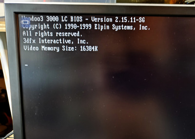

444.19 KiB
837 views
Booting up, it turns out this card is actually a Voodoo3 3000 according to the BIOS startup screen. I had thought it was a 2000 originally, so that was a pleasant surprise. 😁
I haven't put any solder mask on the final repair, as I'm going to test out the card some more first. It might not be completely invisible, but I don't think it looks too bad, even without the solder mask.

Reply 26698 of 27649, by Shponglefan
H3nrik V! wrote on 2024-02-09, 15:26:
Good work! However; such a short break, I would've probably just flux'ed and drawn solder across it ...
I'd considered that but my concern was the close proximity of the other exposed traces. From the top exposed trace to the bottom exposed traces was only 1 mm. Even applying solder mask and then re-exposing and trying to bridge the broken bit seemed a bit risky to me.
I didn't want to risk the possibility of creating a bridge given that would be more difficult to clean up and then potentially cause more damage in the process.
