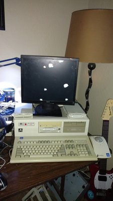

Bought a few more 5.25" 3.5" Drive bay Mobile Racks for my other RetroBoxen on Monday, and swapped the one in the 486 yesterday. Looks like Redmond's Computer Surplus is running out of retro-equipment now so I may have to stick to RE-PC, AMIBAY, and E-BAY from now on. They did quite a cleanout, the CRT that was there - gone. Was stempted to ask about the 486 and the AT Pentium (missing side cover) they had but considering the guy at the shop was once again asking me "what are you doing with that 20 year old technology" again, I just decided to buy my parts and head out - cleared out all the old IDE Mobile Racks that were compaitible with one of the sleds I already have. The black one is going in my Tandy 1000.
For the 486, this is what was done...
New Beige 5.25" Mobile Bay Rack thingy had it's keylock disabled. I can't use one of these unless I have the keys, NONE of mine have the keys, the way to disable the keylock on these is to pull the connectors from the pins on the keylock, and short them together with wire or something else so that the power-line for the Hard Disk is connected and the drive fires up. I'm doing this to all of them before I install for this very reason (will show how to do it on my site eventually).
Then the rack was installed in the 486 (and the black one taken out - it's going into my Tandy). That was pretty quick. But I decided to try 128MB of RAM again, even under 96MB I get a parity error and boot problems. Might just want to stick with 64MB for now. I may order the Non-PARITY RAM for the 486-PVT later this year and see if it's any better.
I also moved the 15GB Drive with my Windows For Workgroups 3.11/DOS 6.22 install on it from the black drive sled to one of the beige ones that matches up to the new mobile drive bay rack. This will just ease the headaches because the internal centronics connectors are all different, don't connect right all the time using other sleds, and whatnot. I'd rather just install the newer one in the Tandy because it actually matches that compute r(black 360K Floppy), and it makes hard disk replacement on the Tandy easier (which is the whole idea of using these things).
I also have started preparing my other hard disks. I'm setting up a 40GB for Windows 98 SE, and I have an 80GB That I'm not quite sure what to do with. I did find out that these drives dont' work properly under MAXBLAST EZ-BIOS like my 15 and 20GB Western Digital drives do - the 40GB comes up as a 126GB HDD (!!!!), and the 80GB does not come up at all to the program. So I used the WD Utility for it. I've got the 40 cut into 4 FAT-32 Partitions already, but I need to take some time to make some new boot disks and whatnot before installing the O/S. One thing I'll say about WD Data Lifeguard utilities on t a 486 - this utility runs a HELL of a lot better on a DX4-100 than it does a DX2-66, It's actually quite a joy to use, when I ran it last time (when my CPU was a 486 DX2-66) it was so slow and clunky it was extremely grating to use (hence trying to use maxblast) - I also may need to learn a thing or two about using the floppy drive to boot from CD, or how that CD works, might be handy for installing Windows.
An odd side note - my 486 tops out at a 2.1GB HDD. I love late era VLB motherboards.
I also plan to test out the 7.2GB Maxtor that supposedly failed and make sure it failed because it's been working fine under USB for awhile, and I was able to recover all my old stuff from the previous DOS/WFWG install I had on it. I also have 2 2.1GB Dirves that will probably be used as "spares" for the Tandy 1000 if they test good. I really don't need an 8GB Drive in my Tandy 1000, I can barely use up 200MB for games alone.
Might break out the Pentium for awhile with one of these racks in it as well, so that I can trick Direct X8 to install on the drives for the 486. Yes, I have used DX8 with a 486 before - and it worked great (IBM PC-330 100DX4). Basically, I'm pulling every trick in the book to build quite a capable system. I'm toying with making some crazy attempts at XP or 2000 Pro as well - IIRC, 2K was always a problem on 486's because 2K does not like Serial mice, and XP requires a 133MHz Pentium.....hehe, but I might find a way around that.
Here's a pic of my (messy) setup.....
