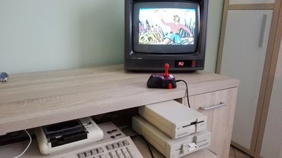

I did repair the power supply of the 1541 disk drive clone a couple of years ago.(dc 5 and dc 12 v) I had to forcefully open the plastic case with some cutting tools, that was the hardest job. Once inside, there were 2 regulators , the 7805 and 7812. One of them was broken, replaced it with a new one, glued the case back , all done. The most difficult part is opening those damn bricks.

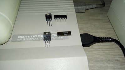

By the way, i did some major maintenance to my c128 setup. The main problem was the datassette: the motor kept spinning , even when no commands were given to load a program. Downloaded the schematics, and found out 3 possible causes: 1.the power transistor that powers the motor, a tip 31. 2. the logic gate that is in series to the tip31, 'U30', if i recall correctly which is normally open, broke up and remained closed. 3. the CPU I/O (and that was a bit of a worry)
144.45 KiB
1099 views
So, i tried to replace at least the first 2 - and guess what, it worked again! Bought some extra spares , just in case.
Had some fun with the Great Gianna Sisters
169.72 KiB
1099 views
I've also fixed the green led of the 1541/2 drive. It was strangely shorted on the back of its pcb, guess it was like that from production.
Also the monitor/tv needed the Scart plug fixed (solder joints were weak), and a nice adjust on the vertical amplitude (both problems very common on mivar tvs)
Last, but not least, a good Azimuth regulation for my datassette. I have to say that everything works fine now.
