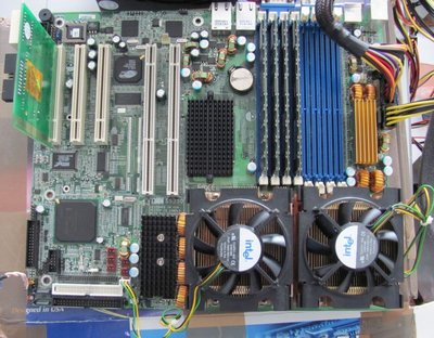

Tried to get this baby to work, but unluckily it doesn´t want to. An F3 error code is shown on my POST card (according to the manual its a Phoenix Bios and bioscentral shows "Initialize System Management Manager" for F3, no idea what this means).Board is a Tyan Tiger i7320 dual mPGA604 XEON. it was known working when put in storage 3 years back. Interesting detail are the intel fans. I didn´t know the Xeons sold in a boxed version including heatsinks and fans.
130.88 KiB
912 views
This frustrated i found an Asus NCT-D for the decent price of 25 € (incl. CPUs, coolers and memory) so i could´t resist.
Reply 8276 of 27649, by luckybob
oh that's nice. If you need some pointers on dualies, let me know.
If you don't end up getting the board working be sure to keep those heatsinks. There are not many (any?) better heatsinks for Socket 604 (that you actually will find).
