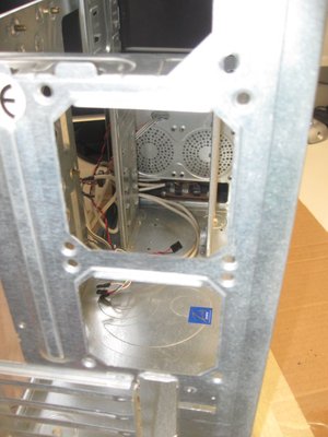

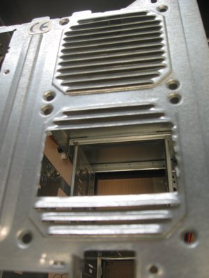

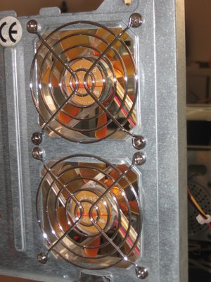

Started chipping off ventilation slots on the back of my Pentium 4 computer case build, to increase better air flow
    395.12 KiB
    2176 views
    Chipping off slots.

    Using a file.
    143.78 KiB
    2176 views
    Finished look

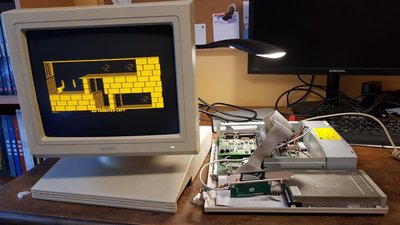

I have soldered cables for my Tandon Hercules build to connect 0 and +5V to IDE-CF adapter. Not the greatest achievement of humanity, but hey, a year ago I did not know how to solder.
I've assembled the computer with the adapter and - lo and behold - it works fine. Boots out of CF image, no problems there. Means I've soldered it well enough. Achievement unlocked!

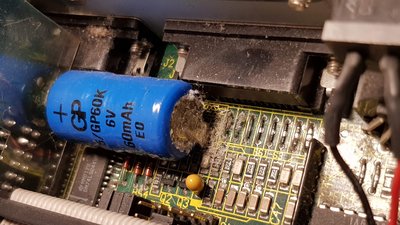

Of course, it was not the end of the story. As I looked closer, it turned out that BIOS battery has spilled:
354.73 KiB
2166 views
It's too late to do it right now, but next task is to cut it out and clean the mainboard. Argh! A couple questions to people who are more experienced:
  • what should I replace it with? In newer computers I use CR2032, but this one is different.
  • how to clean what has already spilled (and possibly neutralise it, in order to avoid further damage/corrosion)?

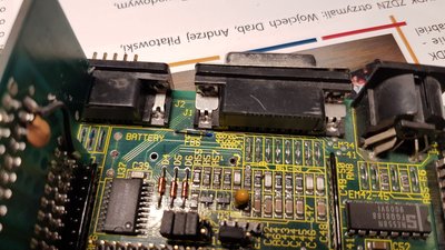

The attachment this_cant_be_good.jpg is no longer available
So I had to disassemble my Tandon AT further in order to get to the mainboard. It was not easy, but finally made it. Desoldered old battery (well, it is more of an accumulator), cleaned the board, reassembled, tested, it works. Now I need to find Ni-MH acu in its place, assemble monitor and board and off we go on our merry way.

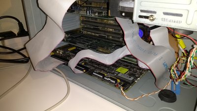

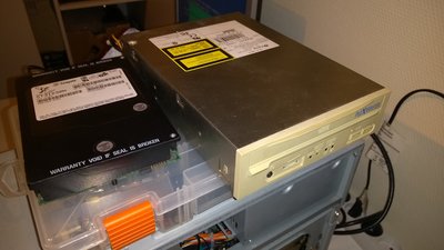

Messing around with SCSI on VLB (two VLB-Cards) 40mhz FSB....

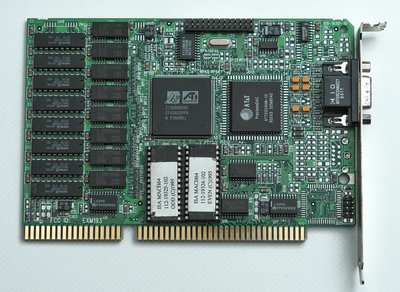

Finally traced down the ultimate ISA video card:
1.83 MiB
2029 views
Now that I have it I am thinking about where to use it. Probably an overkill for a 386 system. For 486/Pentium systems
VLB/PCI cards are suited better... This is a misfit.

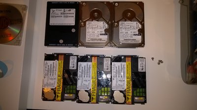

Played some more with my VLB-Scsi card. Tested all of my IBM 10.000-rpm drives in this picture below.
I must have forgotten how loud these things are. Especially the 4gb drives (the 3 black ones)
And they get hot. Like really hot within minutes... Played with FDISK and Speedsys on them.
There are 486 boards with no VLB or PCI slots. I would personally be very happy to have one of these for my U5SX system using this board:
Currently using it with a 256K Cirrus Logic CL-GD5401.. So yeah..
If it was me, I would just buy the same 6V Ni/Cd battery, then remote mount it somewhere else in the case so it doesn't corrode on the board again. I've done this with several servers at work, as well as VME chassis cards. The old one can be removed by desoldering it. If it has glue, you can rock it gently back and forth to unstick it, or very carefully use a razor blade to cut underneath it.. but don't slip and cut the board. I use a a razor blade cutting tool that was made for arts/crafts since they have all sorts of various shaped blades with a nice handle on them for precision cutting. But, your battery looks to be in a difficult spot to cut underneath, so I probably wouldn't use a razor blade in your situation.
No chance in hell I'm using Ni-Cd again. Ni-MH all the way, they don't spill like that.
