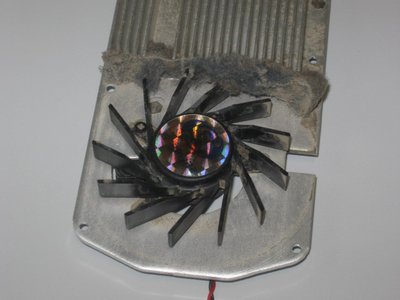

Today I got a chance to test my AGP Sapphire HD 2600 graphics card. Oddly the fan was very noisy and the graphics card was getting really hot really fast without any load. In fact, according to the Speccy program it was above 70°C. So I dismantled the heatsink from the fan and cleaned it. Look what a mess was inside. I also put a drop of oil in the fan bearing, After the restoration the card has 40°C average. How about that...

First thing I do when I get any used graphics card (or any used PC parts, for that matter) from ebay is take it apart completely and clean it thoroughly to prevent such... undesirable behavior. 😀
Also, if you want to further upgrade your card's cooling potential, get this cheap VGA cooler from ebay (https://www.ebay.com/itm/VGA-PC-Computer-Vide … 872.m2749.l2649). I got one of these for my ATI Radeon 9800 Pro to replace the rinky-dink cooler it came with. And I just checked the packaging for this cooler, and it states that it supports your card's model. Wouldn't hurt to check it out, eh? 😀

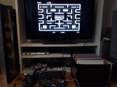

Took the CGA card I bought a while back for a spin. It works which is a good start, know I just have to figure out why it only displays monochrome. The BIOS is set to use 80x25 color so it should be good. Who knows, I don't have jumper settings for the board nor do I have a real composite cable (although a regular audio cable should do just fine). Lots of stuff to test after my new Thinkpad E485 stops fighting and accepts Linux as his new OS which has to be done first..

Judging by that picture, a possibility is that the TV may not support the NTSC color burst signal. The only real way to rule that out is try the card on a different TV.
Another possibility is that perhaps having it set to 80 column color is disabling the color burst signal (as 80 column mode doesn't support it), so try setting it to 40 column color mode.
