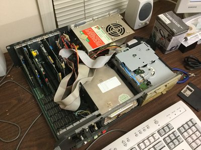

Reply 9765 of 19648, by liqmat
The 286-12 restore is quickly coming to a close. All the cards are in and setup. MS-DOS is installed. Every component got a scrub in the bathtub. Tested interleave values with SpeedStor on the MFM hard drive for performance benchmarks. Interleave setting of 2 was the sweet spot for this setup. Takes a lot of time to do this because you have to low level format the hard disk every time you change the interleave setting and then fdisk and full format after that, but the performance gain is worth the time.
Big difference in performance of course:

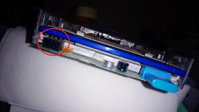

Reply 9768 of 19648, by Thallanor
I have spent the last couple evenings trying to find out why the 720K floppy drive in my Tandy 1000 TL/2 was not working. I presumed it was simply dead. A bummer since Tandy feeds power through the floppy cable too, meaning any replacement would require I hack the cable as to not bake whatever drive I put in place. I continued poking at it tonight though and noticed that I didn't hear the drive spinning when a disk was in place. A friend suggested I poke at the switches at the front of the drive (circled in the attached picture) and insert and eject a disk over and over again to work the switch. Tada! The first couple times, I had to lightly press the corner of the disk down to get it to detect and spin. But after doing the insert and eject trick over and over, it seems to have worked things loose. I need to get some contact cleaner on a toothpick or something and try to get it to soak inside, but for now, it's working! Getting this drive is important to me because I'm getting an ISA 1.44M floppy controller this weekend but without being able to install the 2M driver to access the floppy controller (and another program for Tandys that disables the onboard floppy controller), I would be dead in the water.
Finally, making progress!

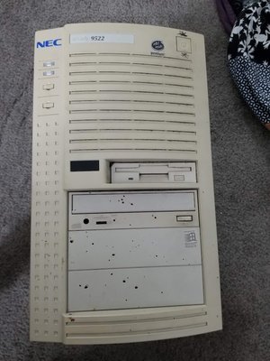

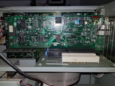

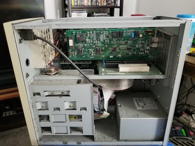

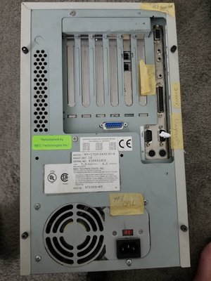

Reply 9769 of 19648, by creepingnet
Replaced the LianLie RH17 Mobile Rack in the 486 beacuse the old one died using a Laptop 2.5" HDD in an experiement in installing WIndows XP......so now I have a new one in there. However, I think I learned my lesson about hacking the power-interface key to disable it - DON'T - I took it apart thinking I just broke a wire or something - nope, surprisingly, there is actually LOGIC inside of one of those things (basically an eight pin SMD IC - probably to methodically switch the power lines off the drive before removal). It was one of those "might as well" things through since I DO have a need for some more RH17 trays for future youtube videos.
After getting hired on a new job, and waiting for my start date, decided to take on the data-recovery a friend wanted me to do. The agreement was I get to keep the computer & monitor if I can get the data off of it (it's her Grandma's old PC)....well lookee what I have here, a rare LPX based Socket 5 Pentium Tower - with a Micron branded CRT Monitor - so that's 2 out of the three (That is unless I decide to ditch either the Tandy or the 286....but we all know that's not happening and I might be keeping this PC as well). We were talking about this since may.
The Monitor has some nasty stains on top, but I'm sure I can make those at least look better, if not completely clean them entirely. Also looks like it might need some recapping and possible voltage/focus adjustment eventually, nothing too scary.
As for the computer, pretty cool, forgot NEC made computers. DId some poking around, looks like it has what probably is 16 or 32MB of RAM on 2 EDO SIMMS, it's a Socket 5, so it's definatley a 2nd generation Pentium, pulled the heatsink, no paste, one of those aluminum embedded pads for cooling, can't really read the digits either on the CPU Chip, but it is indeed a Genuine Intel Pentium processor in there. Not sure what clock speed. It has built-in sound, SVGA (with 2 open PLCC Slots for more VRAM - same as my old 486's S3 card), Serial, Parallel, and Game, and 4 ISA Slots and 2 PCI Slots. One ISA slot hosts a full length Modem card of some kind that I'll likely yank out as I'm not likely to ever use dial-up again. Looks all original too, so I might just restore it after the fact and maybe have one actually period correct system - though I tend to lose all resistance and eventually soup the crap out of it in the end into basically a Monster Truck vintage PC.
Data recovery starts tomorrow, might just be able to jam everything on a DVD-RW disc considering that hard disk is likely smaller or at most as big as 4GB in size assuming it's original.

Reply 9774 of 19648, by creepingnet
bjwil1991 wrote:
Don't forget to replace the clock battery/RTC Dallas clock since those machines would refuse to boot, even after "saving" the settings in the BIOS. My Packard Bell did that, and I put in a temporary solution until I put in a 2x AA battery holder soldered to the clock battery leads on the motherboard and it fires right up in a split second.
Yep, that's the problem with it, and the only one. Otherwise boots right up to "no operating system found". It's got a surprisingly modern BIOS for a Socket 5 system, the last Socket 5 I had (GGateway 2000 I rebuilt for a friend whose still using it to play DOS/Win9x games to this day) was more primitive BIOS wise than my 486 is.
Today I cleaned and dusted it out, powered it on, it works. It has 16MB of RAM and a Pentium 100 in it. It also has an IR Reciever on the front (First time I've ever seen one of those headers actually used before). The motherboard is an intel Chipset board with apparently Opti video. The modem must be a hardware modem, not a winmodem, given it's size, not sure what speed thouggh, could be 56K for all I know. The only thing not working is the O/S, and that's likely because of the failed Dallas Clock chip as mentioned (though it's a different brand than Dallas).
The HDD works, Data recovery was a breeze being as it was only a couple gigabytes in size (the original Seagate Medalist), pretty much an all original NEC with the only possible exception being the Modem.
The Micron monitor I got with it, I just finished a focus and voltage adjustment on the flyback - it has a nice access hole in the back of the monitor for it you just pry off with a screwdriver. Rather nice. My NEC MultiSync monitor has 2 holes drilled into the side so I can adjust like that on the outside as the flyback on that is located on the side. My current plan with my vintage stuff is keep the original PSU's and Monitors as long as I can, and learn some electronics repair in the process (already learning to make guitar pedals so I'm finding learning Monitors and Power Supplies a breeze).
It's also nice to use the Micron on the 486 and be able to use 800X600 reliably again, the graphics are sharp as a tack!
