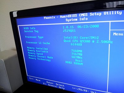

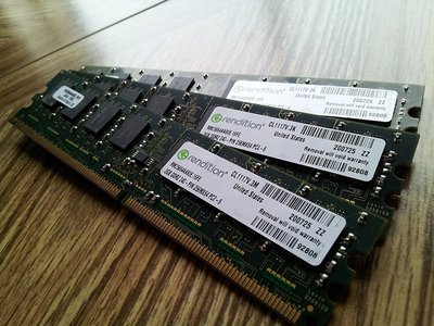

Today I upgraded my "modern" gaming rig (Q9300 + GTX750Ti) from 3GB RAM (2x1GB + 2x512) to 7GB (3x2GB + 1x1GB) after watching it chug a bit in LawBreakers. Because even numbers of memory are for chumps.
For a bit of retro-ness, I found this in my stash of RAM, so it's what I used:
216.66 KiB
365 views
Yes, this is the same Rendition of Verite V1000/2x00 fame - well, sort of. Seems the company's assets were bought out by Micron after they tanked, who decided to use the brand on a line of budget RAM several years later. I have no idea why they thought this made sense. I don't understand big business, like, at all.

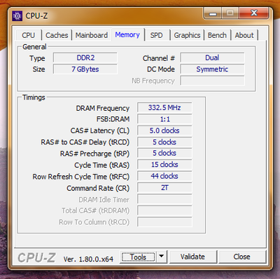

Incidentally despite the mismatched memory config, it still seems to be running in dual channel mode? Not sure why this works, but I'll take it.

I ran 3DMark06 (which was not memory limited under the previous config AFAIK) to test it out, but it didn't seem to change much.

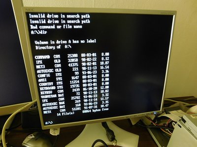

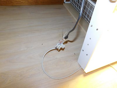

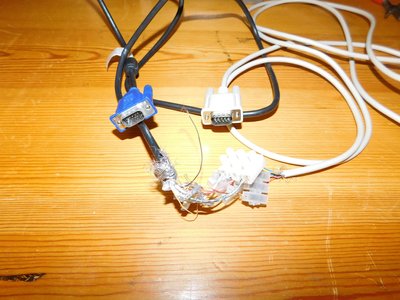

I'm testing some old computers with CGA and EGA cards. The issue is that I do not have any monitor that support the digital TTL signal, or so I thought.
I own a NEC LCD1990FXp TFT screen that is known to suppoort most analog signals but the manual dosn't mention EGA, CGA or TTL at all. The former owner said the monitor supports every video signal known to man so I thought that it was worth trying to see if it could handle CGA/EGA TTL signals.
To be able to test this a professional CGA/EGA 9pin to "EGA/CGA 15pin" cable is needed.

Well it seems it works! 😀

Well the secret sauce is just having a a monitor that recognizes all types of signals and scanning frequencies.
I first tried with a VGA 9pin to 15pin cable but that didd't seem to work. I had a weak memory of getting some Frankenstein contraption with this NEC TFT monitor when I bought it and after some digging in one of my storages I found this cable. The issue was that some leads had come loose so I had to do some trial and error and I had no idea if it would work with digital TTL signals.

well, I own a very similar monitor, so if you would be kind enough to post the details of that cable, I'd love to try it out on my monitor.
Reply 9819 of 19648, by Skyscraper
I will poke around with the multimeter tomorrow to see exactly how the pinout ended up! 😀
