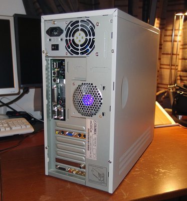

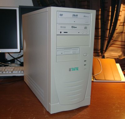

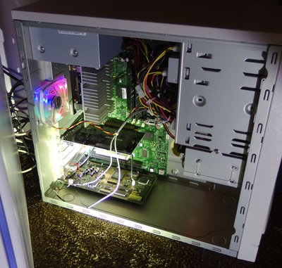

Finished building this system to fully working condition:

Unfortunately I don't have an I/O shield for this motherboard

Specifications:
- New COMPAQ Prosignia 720 slot 1 ATX motherboard (Intel 440BX chipset)
- Intel Pentium III 500MHz CPU
- 2x LG 64MB PC100 CL2 RAM (128MB)
- Asus NVIDIA Geforce3 Ti 500 AGP graphics card
- Creative Sound Blaster AWE64 Gold ISA sound card
- Transcend 32GB SSD with Digitus PATA-SATA adapter
- New Asus 16x DVD-ROM
- New AOpen 52x CD-RW
- Samsung 1.44MB FDD
- AOpen LED 80mm fan
- New AOpen 250W ATX power supply
- Time Colossus ATX case (comes from an e-waste container)
I like unique (or should I say Frankenstein?) setups that nobody else has, I think this one matches that preference.
This little project wasn't easy and took hours, I ran into the following issues:
- Finding suitable documentation about the motherboard -> ended up downloading quick specs of Proliant 400 and Prosignia 720, as well as a manual of the Deskpro EP series with a very similar motherboard
- PIII CPU that didn't work -> replaced with a working one that does have all capacitors 🤣
- SW1 switch that needed to be adjusted for the 500MHz PIII -> needed the Deskpro EP manual for this
- Motherboard that didn't like my ECC modules -> eventually just installed a regular non-ECC pair of LG that does work
- No video -> graphics card didn't make good enough contact in the AGP slot, have adjusted its position a little and decreased tightness of screw
- Disk controller error 601, didn't recognize FDD -> eventually found out that COMPAQ motherboards need an untwisted FDD cable, luckily I still have one!
Now it's ready for a Windows 98SE installation and all its drivers!

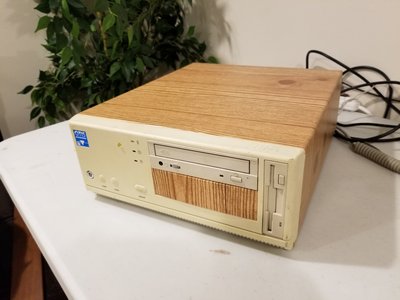

I'm a little late to the party, but a post on here finally pushed me to go woodgrain for one of my machines (386sx-25). The cover was in rough shape before, so this was more of a test than anything. But I'm really happy with the result!
