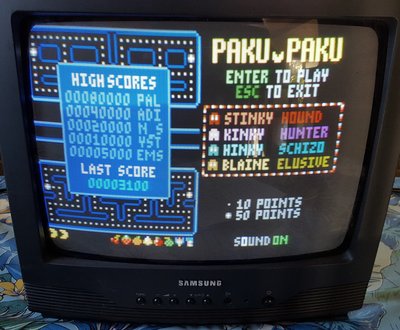

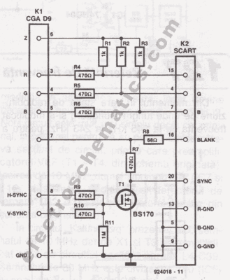

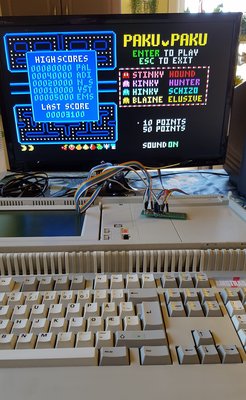

I finally made a CGA to SCART adapter. I followed this schematic.
The picture are fine. Especially on the CRT. On the LCD the screen is "crawling" and the colours ar not so bright. The photos does not show this. The photos show more vidid colours on the LCD, but this was not true when i looked at the screens.
I am very surprised how good the pictures are. I will recomend using this method for others.
PS! There is en error on the Schematics. Wher it says 4-G on the scart it should be 11-G. Also where it says 7 in the input side. Do not connect this to 7 in the CGA but to 7V+. Other descriptions says 5+ - but that did not work on my LCD or CRT. Also memember to connect 5V- to ground.

    CGA to SCART on CRT

    CGA to SCART on LCD

    CGA to Scart Schematics
