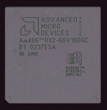

Reply 37 of 50, by feipoa
Mau1wurf1977, which desolder station do you have?
JaNoZ, which hot air rework station do you recommend?
JanoZ, why do you want the AM5x86 to run at 2x? I do not see much value in running such a chip at even 2x66 when 4x40 has better performance. At 160 MHz using a 27 MHz PCI bus, the 160 scores 17.3 fps in Quake 1, while the 2x66 receives 15.1 fps with a 30 MHz PCI bus. The Am5x86-16KB-WB does exist. This is the one from my collection,
28.64 KiB
1891 views
Look at that mid-2002 datecode. I think the B1's were the last editions.
I think the most optimal Am5x86 setup is to run the chip at 60x3. Of about a dozen chips I have, I could not obtain a stable chip at this speed at 4V or less. I'm sure some do exist though. I know some people who have been able to run the Am5x86 at 3x50 with the L2 on the fastest 2-1-1-1 timings without problems provided they restricted the L2 cache to 256 KB of double-banked. You should use a board with a 2/3 PCI multiplier in this case, otherwise it seems silly to run a 50 MHz bus on a PCI-based board. 4x40 is probably the best compromise for the Am5x86. I have at least one board which will run 1024K L2 WB cache on the fastest L2 settings, 128 MB RAM, and a 40 MHz PCI bus.
To determine if a board will do 60 MHz "properly" depends on many factors. First is the PCI bus, if it can be set to 1/2 and 2/3 of your FSB. At 60 MHz, the slowest L2 cache timings should be fine, however it will yield slower L2 throughput compared to the same chip at 40 MHz and the fastest timings. On the up-side (and if I remember correctly), I beleive the RAM speed is slightly faster. Usually a single stick of 64 MB RAM and double-banked 256 KB cache should be best for testing purposes.
