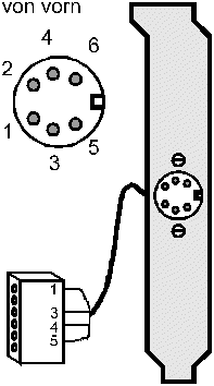

Reply 17 of 18, by Blazejos
I solved this problem around 2005 because in paper manual wasn't any information about PS/2 port pinout so somwhere on Shuttle HOT motherboard website was this picture
3.7 KiB
1931 views
Pin Beschreibung Farbe 1 Farbe 2
1 Data rot weiß
2 nicht belegt - -
3 Ground grün schwarz
4 VCC gelb rot
5 Clock blau gelb
6 nicht belegt - -
