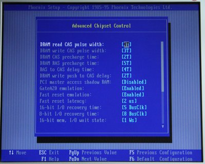

I did a full scan of the Phoenix BIOS version of this board. I couldn't find it online:

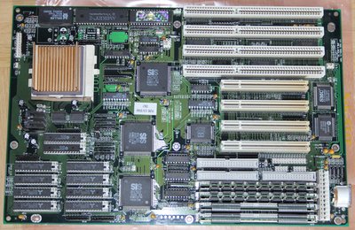

Finally - also thanks to the previous post - I got my white "porno" Elitegroup SI54P-AIO repaired 😎
- replaced the caps
- replaced the BIOS chip

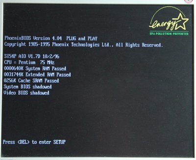

BIOS image was not esay to find so hope its OK to upload it here. I kept the Phoenix as its nicer and more unusual than the AWARD that was installed before.

Please post a picture with the Voltage regulator
Mine is unreadable and I am looking for a replacement

My ECS SI54P AIO can use a Pentuim 133 MHZ on this board with that Phoenix v1.7 bios..
I dont think it maybe would do that stock * but i have to test this*
But it will do with an CPU VRM upgrade socket (for socket 5 / 7) which will provide much more multipliers.. On stock they cant be set manually.
I also will included my old Award bios 12 here for just helping out.. But because its a very earlier version it wont reconize faster then the Pentium 100.
The VRM is a single one.. LT1083CP (its a fat one and needs a heatsink)
