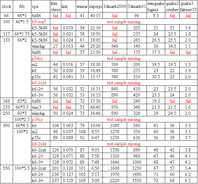

test platform:
mvp3 board with 2mb cache
256mb sdram
geforce2ultra
windows2000sp4
results:
23.46 KiB
2372 views
a few notes:
1. the k5-ssa5, p54cs and old k6-2(26050) are currently missing. they are not really rare, but i feel the price not worthy for just benchmarking purpose, so i am not urged to get them now.
2. the cyrix 6x86 failed all opengl tests with nvidia cards, it worked with an ati rage128 but i don't want to post results with a different card.
3. 3dmark2000 refuses to run on cpus without mmx instructions, so it failed on 6x86 and k5, its also expected to fail on p54cs. surpringly 3dmark01 managed to run on them.
4. the k6-300 i got is a mobile version, it runs well at 66*4.5 but at 100*3 it goes BSOD very quickly, i guess it just can't handle high fsb so i have to post the 66fsb results for the 300mhz group.
5. the k5 overclocks poorly. its a common pr166 rated at 117mhz and crashes very quickly at 125mhz, its 133mhz result is calculated by linear estimation(how much difference between 117 and 100).
6. the viac3 is not a socket7 cpu, i put it in the list because its performance is even worse than those. its run on 440bx board with 256mb sdram, geforce2ultra and windows98se, i am rather lazy to spend time installing the same win2000sp4 on the 440bx rig.

The K6-3+ 550MHz 3DMark2000 score of 2220 is lower than I expected.
I used to get about 3000 on an MVP3, K6-3 450MHz, Geforce2MX. Unless my memory is off by 1000pts, but I don't think it is.
The differences I see are that my system back then was Win98SE, yours is Win2k SP4. I was also using an older nVidia driver, v5.32 I believe.
I do remember seeing slower performance with a later nVidia driver, but by later I mean something like 6.x or 7.x. I never tried a version remotely close to the one in this test.
Do the drivers and Windows version possibly explain the difference? I don't think I ever tested that system under Win2k, so I don't know what it would have done there.

results updated! most socket7 cpus are included now.

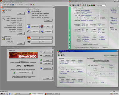

I can't believe it's been so long, but I finally have my old super socket 7 system back together, and I've been doing some benchmarking with it.
I think I've basically recreated the setup I had back then. It's not technically the same video card - my card back then was a Hercules with faster RAM, but what I tested here is a standard MX.
I don't remember what version of the AGP driver I had back then, so I made a best guess.
Tyan S1590 (MVP3 chipset, 1MB cache)
K6-3 450MHz
256MB PC100 CL2
Geforce2 MX AGP (default clocks: 175MHz core, 166MHz 128-bit SDRAM)
Win98 SE
VIA AGP driver 4.17 installed in "normal" mode (which I believe just means it stays in AGP1X, not 2X)
nVidia driver 5.32
3DMark 2000 v1.1 default benchmark (1024x768x16, hardware T&L)
98.88 KiB
1325 views
2873 points
My card in those days had faster RAM, but this is a standard model and it comes close.
I remember that back in the day, the score tanked by about 500pts if I installed a later driver, so I stayed with 5.32.
5.32 had some graphical glitchiness at first - the solution for that was to install the VIA AGP driver in "normal" mode. That option was only offered in older VIA drivers, so that's why I used an old VIA driver along with the old nVidia driver.
Later nVidia drivers would fix the graphical glitches, but they also slowed down the card significantly so I preferred to get it working with 5.32.
That info is from a long time ago, I haven't tried experimenting with driver versions on the current build. I might still experiment. Interesting that you had good results with 8.05, I might try that out.
I'm suspicious that maybe nVidia 5.32 was optimized better for the K6, and then they changed something shortly after that when they didn't care about the K6 anymore. Or another possibility - maybe K6 optimization has nothing to do with it and it's an issue with how they addressed the glitchiness of VIA AGP.

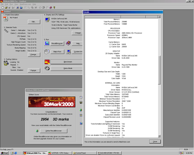

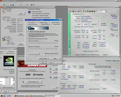

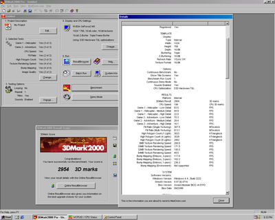

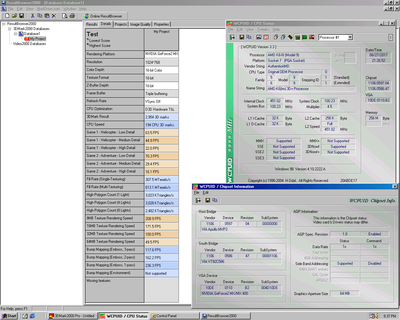

The Hercules "3D Prophet MX" that I had back in ~2001 ran the GPU at standard 175MHz but had faster RAM clocked at 183MHz.
I don't have that card anymore, but I overclocked my current card to those settings to match.
148.34 KiB
1325 views
2954 points - it's only a modest difference but that's the scoring I remember getting.
