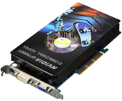

Sphere478 wrote on 2021-11-25, 04:02:
cyclone3d wrote on 2021-11-25, 03:14:
Sphere478 wrote on 2021-11-24, 23:24:
needs two notches. those get harder to find the newer they are
Yep, All the ones I have have two notches 😀
Can you send a link? I can’t find anything faster than a 7600 for sale with two notches
7900GS on eBay right now - Not my sale:
https://www.ebay.com/itm/284526840774
271.21 KiB
1516 views
Pic of a 7950GT two notch
22 KiB
1516 views
The 7900GS and 7950GT cards I have are XFX. Only pictures I could find show a single notch.
I'll have to double check the cards I have but I am pretty sure they are all two notches - maybe I am mistaken. I'll post pics of them when I am back home.
Here is a youtube video that compares a bunch of different higher end AGP video cards that has a few of the 7x series that have two notches.
https://youtu.be/AFaC5JVSMPg

Reply 126 of 152, by Sphere478
cyclone3d wrote on 2021-11-25, 23:21:
7900GS on eBay right now - Not my sale: https://www.ebay.com/itm/284526840774 7900GS-Galaxy-two-notches.jpg […]
Too much, I’ll keep an eye out. Thanks!

Reply 128 of 152, by cyclone3d
Well, I was completely mistaken. Looked again at my 7800GS, 7900GS, and 7950GT cards and all of them only have a single notch.
In any case, it has already been proven that the Geforce 2 and Geforce 3 series are the fastest possible solution for Socket 7 due to newer drivers having too much overhead.
