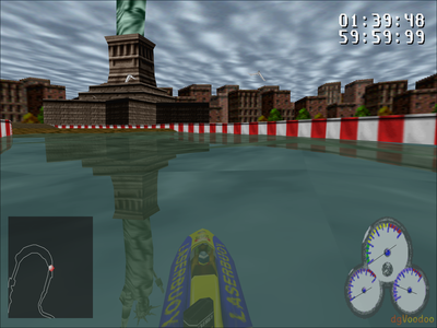

    277.36 KiB
    2776 views
    There are some artifacts because I forced MSAA on the game.

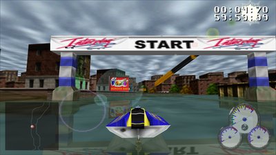

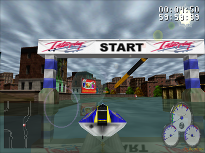

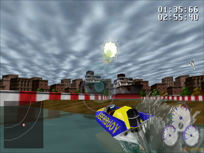

Reply 19 of 21, by FANTOMAS
@DGVoodoo 2.55 Does it look OK ??? I do not really know ..... 60 hz v-sync is steady...... the game itself is a dinosaure from the Direct-x 5 era........
Config : ASUS PRIME H270 PRO / CORE i7-7700/ 16 GB DDR2400 / MSI GTX1060 6GT OCV1 @391.01/ Moniteur @1080p ...WINDOWS 10 64 bits V1803 @17134.254
    789.98 KiB
    1365 views
    16/9 @3840X2160 @DSR 4X
    1.19 MiB
    1365 views
    1600X1200 @4/3
    1.12 MiB
    1365 views
    1600X1200 @MSAAX8
    1.38 MiB
    1365 views
    1600X1200 @MSAAX8
    1.28 MiB
    1365 views
    1600X1200 @MSAAX8
