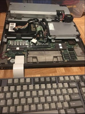

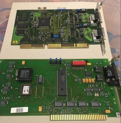

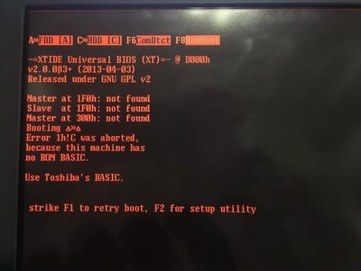

Sorry to wake up this thread,
Since I am quite new to this there is a lot of confusion on what to do and how to solve problems. I recently bought two half broken T3200SX and am combining them to one working system.
Unfortunately the system will not boot when I remove the HDD and only plug in a XT-CF-Lite v4.1 with xtide.
76.63 KiB
4653 views
Here are my initial questions and confusions:
1. Is it possible to run the Conner HDD and CF disk at the same time so i can backup the data? Tried to set the onboard controller in xtide, did find him but can not find the harddisk. Maybe i just have to remove a bootflag from one of the drives? not sure but if both are active the system stops in the xtide booting C> prompt and all options are a dead end.
62.96 KiB
4653 views
2. What hardware would i need to get - to get rid of the Conner and switch to CF, maybe even use the internal ports from the onboard controller? EEPROM writer, empty bios chip, etc? Can the onboard ide support two CF cards on IDE on one Cable (master/slave)?
I got the Conner Disk from one System working and found some interesting Industrial software (probably automotive) that I want to have a closer look at combined with two custom ISA cards. That machine was apparently run until 1999 and has a working (maybe not stock?) FDD from Panasonic.
90.5 KiB
4653 views
best reg4rds for the help
\ chozilla

Hi, chozilla, I don't have got a T3200SX but maybe I can answer a few of the questions. ^^
So it booted from the original HDD, at least ? If so, that's good. ^^
In theory, yes. As far I know, the XT-IDE card uses the I/O addresses that were common in PC/XT systems.
So it shouldn't collide with the AT standard ports. However, I don't know if the XTIDE Univeral BIOS (XT)
can coexit with the IDE/ST506-code that's in charge in AT-BIOSes the same way the XTIDE Univeral BIOS (AT) can.
(The AT-Version, "Large" at least, of XT-IDE BIOS can give control back to the original AT-BIOS code, e.g. you can press
a button an let the BIOS boot from HDD.)

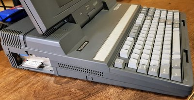

No need to be sorry, that's what this thread is about. As for your other questions, I'll defer to jaZz_KCS and others, as I have no experience whatsoever with XT-IDE. That said, I can help with question 2.
I got rid of Conner drive and have a CF card instead. It's very comfortable!
In order to do that:
1. downloaded 003C/003I HYBRID BIOS ROM from here: http://omolini.steptail.com/t3200sx/files.php
2. programmed chip with BIOS using local electronics shop as I do not have the EEPROM writer. Used this particular chip EPROM 27C1024 DIL40 (UV) AMD 70ns (latency needs to be below 85ns). It all cost under 10EUR together with the chip.
3. carefully removed BIOS chip from motherboard, put newly programmed chip inside.
4. connected IDE cable and IDE to CF adapter in order to check if it is going to work. It did.
5. once set-up, I used rear-mounted IDE to CF Adapter Card with a PCI Bracket to put CF card in accessible spot (one of the ISA expansion slots in the back) so that I don't have to open Toshiba in order to add something on the card. I had external help with that, as the assembly was not easy.
Let me know if you need more pictures.
That's how it looks now:
