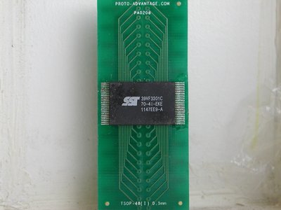

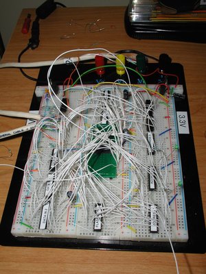

I've been mostly silent, but not idle. Fuguring that it would be wasteful to expect everyone who wants to build such a card to have a flash programmer, I started looking for alternatives. As a first step, I wanted to make sure I could produce a design that would allow software to write to the chip. To that end, I started prototyping a parallel port programmer that I intend to have support a very limited number of chips (or maybe even just one type of flash). This will either serve as a learning phase for later implementation of in-circuit programming on the ARGUS board itself, or as the eventual end product. The advantage is that one should be able to assemble one of them for less than $10 in parts (plus a simple PCB, if we go that route).
Since I couldn't source the part that shock__ is using quickly or cheaply, I decided to start with a part that has a slightly simpler programming protocol. It is a 3.3V part, and I am using similar chips to those already on the board to provide level translation "for free". If we like this approach for programming the chips, I will worry about getting a few of the AMD chips and making the necessary adjustments.
It's still a fairly early-stage prototype, but my current "rats' nest" is pictured below:

This is the current flash chip, on its adapter board:
222.21 KiB
746 views
I am currently still dealing with a few design revisions and timing gremlins, but the basic design should be workable. If anyone has any better ideas, please do share.
Reply 1231 of 2612, by gdjacobs
Looks ready for production! Just need a 200 layer PCB. 😎
Reply 1232 of 2612, by 640K!enough
A 200-layer board, you say? It looks that bad, does it? This little endeavour reminded me why these solderless monstrosities were never my favourite tools. I have already spent more hours than I care to count hunting down inconsistent or outright incorrect behaviour, caused by loose, intermittent or pulled connections. I should have at least wire-wrapped the thing from the start; it might have avoided a good deal of unnecessary frustration.
While there are still a few timing issues and one mystery failure condition to deal with, data transfer testing, reading and resetting the chip seem to work fairly consistently. I haven't tested my write implementation yet. If I don't have to slow it down to avoid corruption, transfer speeds are quite passable; nowhere near the performance of a commercial programmer, but it shouldn't take an eternity, either.
For some reason, every few thousand data transfers, one of the latches will become enabled without my having selected it and take on a new, incorrect value. This results in the flash coming out of suspend, and dumping data on the "bus" when it shouldn't, corrupting the data being transferred. My theory, so far, is that it's due to the voltage thresholds being a little different for some of the parts, and an additional select signal is being generated while the inputs are not yet valid. I already have a few ideas that I think may solve the problem, but feel free to chime in if you have any input.

Reply 1235 of 2612, by 640K!enough
gdjacobs wrote:
Well, there was a bit of hyperbole on my part. Breadboarding is always messy.
I know, I took it as a clever, but truthful stab at my mess. Just for good measure, I've made it into an even bigger mess since that picture was taken.
Synoptic wrote:
sometimes, parts from a different manufacturer will solve such behaviours.
I think I have that problem fixed. It looks like my theory was at least partly right. I added another 5V-tolerant latch between the logic that generates the select signals and the parallel port, and that seems to have made enough of a difference in the voltage thresholds and rise/fall times that the problem hasn't shown itself since. I still want to do a little more testing to be sure, but it looks like that has eliminated the latch selection problems, and resulting corruption, without having to introduce additional delays via the software.
