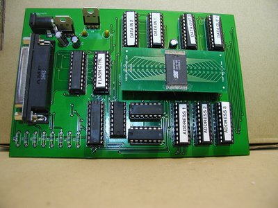

Reply 1241 of 2612, by 640K!enough
Finally, it has gone from the rats' nest on the previous page to this (my apologies to the actual electronics guys if my attempt at layout and routing makes your brain hurt):
421.75 KiB
652 views
After the hours spent chasing odd behaviour, it turns out that most of the problems really were caused by that solderless monstrosity; even my soldering job on the flash chip doesn't seem to have been part of the problem. The basic software design seems to have been sound all along. I still have to refine the timing and add support for the chip erase and program command sequences, but that should be much less troublesome, now that I can be sure the signals are actually reaching the flash IC intact.
While interesting, I don't see how moving this work to the ISA bus would advance anything, for the moment.

As of last night, chip-erase and word-program are functional. With a little more test code, I'll be able to write a full ROM file to the chip, verify and dump the contents. When that's ready, I think it will be time to start discussing what we plan to do with it.
Reply 1245 of 2612, by 640K!enough
Even with the basics already working, getting the rest of the flash programming functionality working properly took some time. The file programming operations were inexplicably failing. Sometimes, it would work as expected, and other times there would be varying amounts of corruption. It wasn't until I decided to write some more targeted test code that I isolated the symptoms: small files were fine, and there were more failures and more corruption as the files grew. The reason: I was wrong; my soldering job on the flash chip wasn't good enough to be trouble-free. The pin for the most significant bit of the address wasn't so well soldered. Now that I've rectified that, I am able to write a full file to the chip, verify it and dump the contents back to file.
As a test, I programmed and verified a full 4 MiB instrument ROM file. It would be nice to see what that sounds like, and to see what IWINIT, IWSBOS and company have to say about it, but that will have to wait.
In case we decide to use a similar design directly, I wanted it to be as simple to build as possible. That meant no programmable devices used in the design, which had a bit of an unpleasant effect on performance. Given that my test chip is only word-programmable and the command sequence must be sent for every word, the result isn't exactly pretty: a complete program and verify took around 8 minutes, 43 seconds. There is a certain amount of code clean-up I can do, but I don't expect any miracles. A complete dump to file takes about 1 minute, 40 seconds; that code can benefit significantly from a little optimisation.
I rather suspect we'll settle on a different flash chip, quite possibly the one shock__ has been using all along. I guess we'll have to make a decision soon enough.

Interestingly, it turns out that the AMD 29F series uses the same command sequences (JEDEC standard, presumably) as the SST part that I used as a guinea pig. So, I adjusted the timing in my test software slightly, and modified the board to use an old 29F400 I salvaged. Here, the chip erase function is significantly slower, but because it's only a 512KiB flash, a full program takes a little over a minute, and a complete dump to file takes about 17 seconds. Since the old chip is a 120 ns part, it will be useless for the ARGUS, but it was an interesting test. A 70 or 55 ns 29F800 (or even the rather expensive 29F160) should work similarly, only a little more quickly for individual read/write cycles.
With the same basic code able to program either chip, in-circuit flashing is starting to look even more viable. Whether we will actually want to try implementing it is a different matter altogether.
