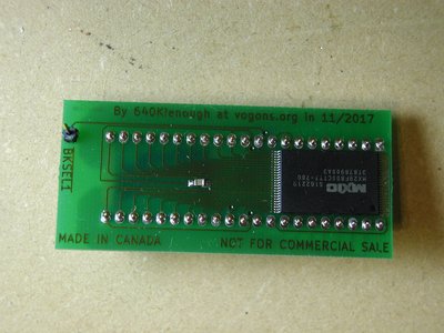

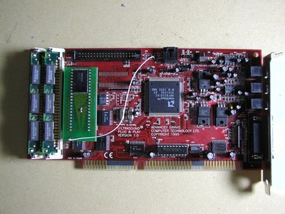

Just thought I'd share a preview of something that I'm working on:
479 KiB
1149 views
It is still a work-in-progress, but it is detected properly and does produce MIDI playback. The playback is perfect on some instruments, and distorted with others. My current suspicion is a questionable solder joint on one of the flash chips. When I have more time, I will investigate with IWDUMP, to see what the contents of the ICs look like. I know that the chips were successfully programmed and that the contents are identical to the ROM image files, so a solder joint seems likely. Clearer pictures, screenshots and audio samples to follow.

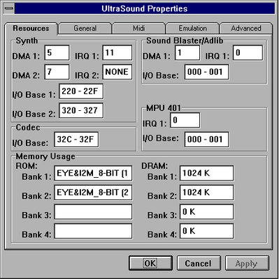

It looks like I was right about the solder joint. The chip on the underside of the board must have had a few pins that weren't as well soldered as they should have been. With that problem rectified, it worked as one would expect, producing clean, distortion-free sound. This is what the UltraSound Properties window had to say about the memory present on the card:
121.1 KiB
1114 views
Notice the dual-bank custom ROM. This should put to rest the theories that ROM sizes other than the InterWave power-up default, or AMD standard of 1 MiB, require a custom driver. Under DOS, PLAY.EXE worked fine, as did any MIDI player I tried under Windows 3.1. It should also prove, once and for all, that we can successfully generate our own ROM images.

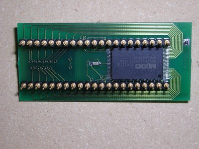

The next two images show the top and bottom of the ROM daughterboard, respectively:
636.26 KiB
1114 views
627.81 KiB
1114 views

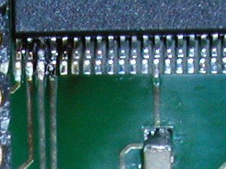

Those changes led to something quite different: there was more current available, which resulted in a bit of a light show, then this:
101.26 KiB
944 views
Aside from also physically destroying the module, removing that flash IC clarified the explanation: there was still some flux residue under the chip that I hadn't managed to clean, and the flux that I have been using, while very good for soldering, is somewhat conductive (and flammable)! With unrestricted 5V on the select line, right next to a ground pin, and conductive residue still sitting on the edge of the footprint under the chip, you can guess the results (shame on me for not putting a resistor in-line, but it helped provide the explanation in spectacular fashion, which I wouldn't otherwise have had). So, yes, the explanation came with the acrid stench of magic smoke. Fortunately, the GUS seems to have escaped unharmed.
That likely explains the problems I was having with the ROM module all along, and the reasons that removing the module seemed to immediately restore normal operation. Undeterred, I will build another one soon (using different flux!), so that I can test more thoroughly, and am already working on a revised version of the board.
