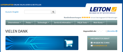

It's happening (with a slight delay).
147.11 KiB
1612 views
Order for 15 boards has been sent out.
