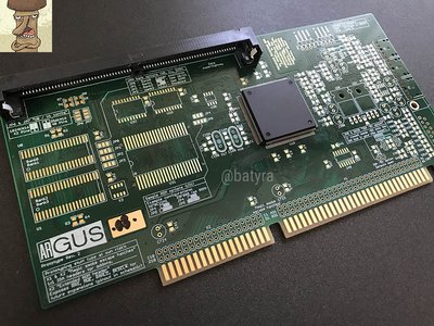

Reply 1480 of 3172, by Batyra
Mine (08) has just arrived! Waiting for parts from Digi-Key now 😁

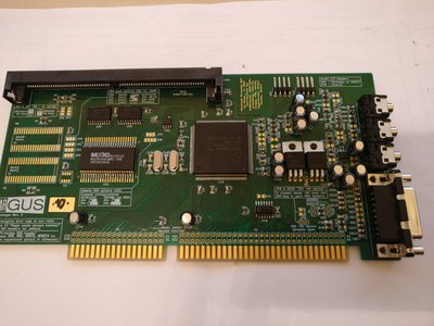

Reply 1498 of 3172, by shock__
What temperature are you using?
Some passives have quite a bit of 'tombstoning' ... potentially leading to shorts. Did you check those? Is the DSUB sitting flush with the edge of the PCB? If it helps it should be a "US type" (there's also a european one).
If you intend to use the screwholes for the voltage regulators the legs need to be bent back slighty kinda like this:
A good way to solder small passives is using the "tack and reflow method". Add solder to one pad, put the component on there using pliers, reheat the solder soldering the first contact and then manually solder the second contact once the component has been aligned properly. Another good "plan of attack" is going from small to big (passives first, then ICs, then jacks/caps/sockets).
If you set JP4 & JP5 you should be able to at least flash the PNPROM, check the wavetable rom for integrity, set the resources. If you install a RAM stick (and set JP0 - JP3), you should also be able to use the card (albeit without any output).
