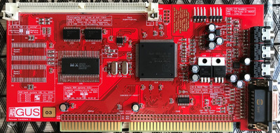

Reply 2293 of 3174, by TheMobRules
ARGUS RC1 #03 reporting for duty! 😎
1.88 MiB
1513 views
I assembled the card during the last couple of evenings, it was a really smooth process and the PCB quality is excellent! I am also pleased to report that I was able to flash the EEPROM and the card got detected by the drivers without issue.
My initial tests on a P133 (basically all the shareware games and sample files that come bundled in the GUS PnP CD) show that everything is working as expected, and I have to say it sounds great! I used a Samsung 16MB 70ns SIMM (one sided) for the RAM, no problems there either with detection or memory test.
I'm still kind of a n00b when it comes to GUS (never had one back then and was unable to participate in the earlier ARGUS prototype) so I'll be investigating in order to perform more in-depth tests in the coming weeks. If you want me to test something specific just let me know, I'll also try to get some recordings.
So congrats to shock__ and everyone else involved in this project, this is awesome!
Now... the card is desperately asking for a bracket, has the community effort to produce these for the production run gone dead? I'd be willing to pay (assuming it's a reasonable amount) in order to have a good looking metal bracket!

TheMobRules wrote on 2020-05-16, 17:33:
Wow ... soldering looks amazing 😀
Nothing planned from my side, except for DIY brackets made from PCB material ... maybe. If anyone wants to take over production of proper brackets I'm absolutely cool with that. Otherwise salvaging from SB Vibra cards still is an option - those usually line up fine if one uses elevated 3.5mm sockets.
